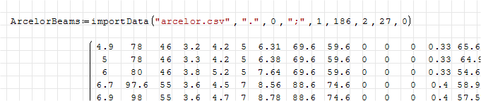

Hi Ioan,
seem there are issues with the first column (the beam type and size); I can not load the column even by enclosing the values in double quotes... except for that other data can be loaded without issues

![SMath Studio - [arcelor.sm].png](/zh-Hans-CN/files/Download/bQQHeG/SMath-Studio---[arcelor.sm].png)

the first column can be read using ExcelRead, this works as long as the cell content is a string or an integer.
Just save the csv as xls. Turn out that ImportData and ExcelRead have complementary features/bugs.
arg3 is arg delimiter for symbolic expressions (in case arg9=1), arg4 is column delimiter in the data file.
Best regards, Martin

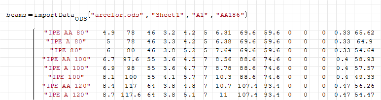

Davide Carpi 2012/12/18 18:22:00
WroteCSV converted with LibreOffice and imported with DataExchange plugin
Best regards,
w3b5urf3r

![SMath Studio - [arcelor and DataExchange plugin.sm].png](/zh-Hans-CN/files/Download/KuNkok/SMath-Studio---[arcelor-and-DataExchange-plugin.sm].png)
