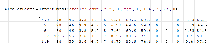

Hi Ioan,
seem there are issues with the first column (the beam type and size); I can not load the column even by enclosing the values in double quotes... except for that other data can be loaded without issues

![SMath Studio - [arcelor.sm].png](/ru-RU/files/Download/bQQHeG/SMath-Studio---[arcelor.sm].png)

Hi w3b5urf3r,
You have all my gratitude.
As usual, you have done a wonderful job.
As all good jobs, after it is done it seems so simple.
I will try to recover the fist column - text - in some other way.

the first column can be read using ExcelRead, this works as long as the cell content is a string or an integer.
Just save the csv as xls. Turn out that ImportData and ExcelRead have complementary features/bugs.
arg3 is arg delimiter for symbolic expressions (in case arg9=1), arg4 is column delimiter in the data file.
Best regards, Martin

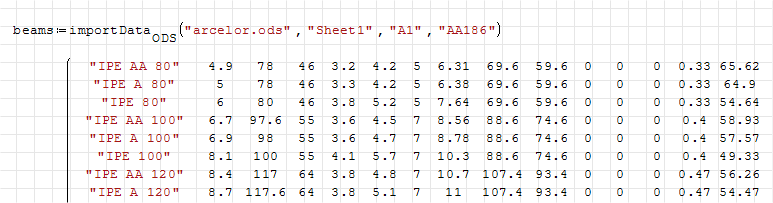

WroteCSV converted with LibreOffice and imported with DataExchange plugin
Best regards,
w3b5urf3r
