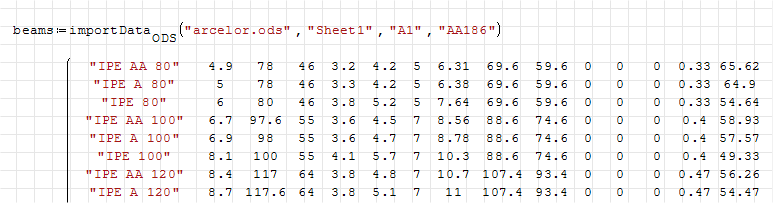

WroteCSV converted with LibreOffice and imported with DataExchange plugin

Hi w3b5urf3r,
Of course it would be preferable if SMath could handle itself a clean Excel import/export operation.
Seeing that it is not yet the case, I appreciate much your practical solution; I hope it is welcome also for others.
BTW:
I've seen that once the "arcelor" table inputed in SMath, it can be read/write, as it is (with text columns included) or modified, with SMath rfile/wfile.
Once again - Thanks
Best Regards,
Ioan
