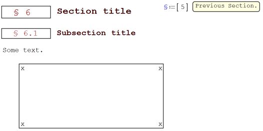

Hi Basile. You can start from any paragraph pointing the value of the variable '§, for example from paragraph six is: '§:mat(5,1,1)
For paragraph 1 use zero as starting value.

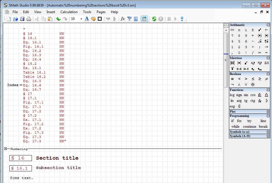

#8 Posted: 2018/10/1 05:04:38
1,308 likes in 2,221 posts.
You can display the index at the begin of the document if you assign it to an absolute variable at the end (those variables starting with a tilde ~)
On german keyboards, the tilde has to be copied from a text region as it is catched as a hotkey for boolean = in math regions).
BTW, why don't you use formatted labels?
2018-10-01 09_58_08-SMath Studio 0.99.6839 - [Automatic%20numbering%20sections%20book%20v3.sm].png
Automatic%20numbering%20sections%20book%20v3.sm (40.27 KiB) downloaded 868 time(s).
