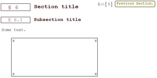

Hi Basile. You can start from any paragraph pointing the value of the variable '§, for example from paragraph six is: '§:mat(5,1,1)
For paragraph 1 use zero as starting value.

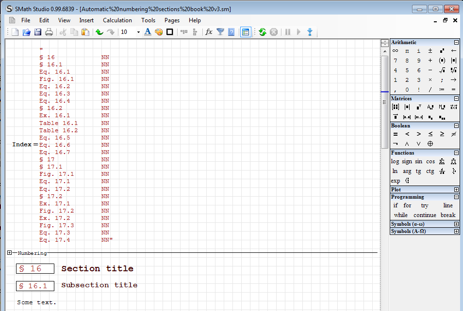

Davide Carpi 01.10.2018 03:25:00
You can display the index at the begin of the document if you assign it to an absolute variable at the end (those variables starting with a tilde ~)
On german keyboards, the tilde has to be copied from a text region as it is catched as a hotkey for boolean = in math regions).
BTW, why don't you use formatted labels?
![2018-10-01 09_58_08-SMath Studio 0.99.6839 - [Automatic%20numbering%20sections%20book%20v3.sm].png](/ru-RU/files/Download/S7nvyG/2018-10-01-09_58_08-SMath-Studio-0.99.6839---[Automatic%20numbering%20sections%20book%20v3.sm].png)
Automatic%20numbering%20sections%20book%20v3.sm (40,27 КиБ) скачан 1594 раз(а).
