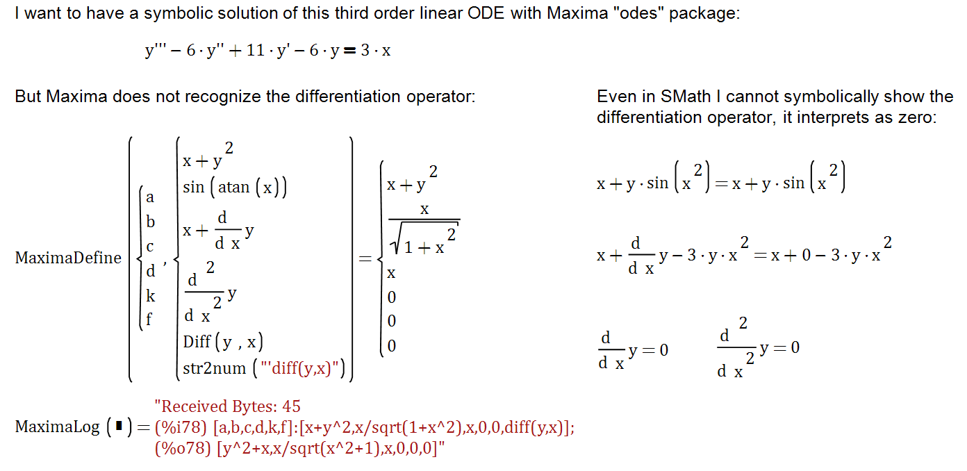

Do you know why or what could be the problem for SMath not translating properly a dy/dx. I need to write these operators in Maxima to solve a differential equation...

I have found a workaround, with eval_string() from Maxima.
Hola tocayo. Is this the problem?: always it is diff(y,x)=0, but diff(y(x),x) remains unevaluated and is the correct form to express the derivative of a function.

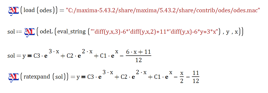

#4 Posted: 2020/5/31 00:16:30
Alvaro Gavilán
Alvaro Gavilán
25 likes in 68 posts.
Hola tocayo, muchas gracias!
Problem solved:
