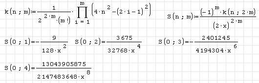

Dear All,
I have got a question / request for help regarding Bessel functions:
First: Is there any plugin or function in SMath Studio for Bessel functions?
(Maybe not, at least I didn't find such a thing anywhere.
My problem now is that I need to calculate some heat transfer problems using Bessel functions as
trancendent equations for cylindrical bodies.
After a short while I found out that Bessel functions are really hard to compute due to the maximum available number range. (It is a general problem since there are very high numbers & very small numbers to compute at the same time).
A lot of much more clever people than me have found ways to approximatley decribe the Bessel functions in a more "computer-friendly" way by using ploynoms for example.
A very good solution I have found is from John Harris, Intel. So I decided to use his approach.
(see attachment). It is working very well so far, but now I want to increase the precision a liitle bit by adding one or 2 summands to his P and Q polynoms (see attachment) But unfortunately I don't fully understand his notation form not even though he is describing it. (sse attachment)
Is there anybody who could help me with that?

Try this. I just literally defined the functions and it seems to work.

Dear mKraska,
you have saved my day. Thank you very very much.
Now I also can understand the notation. I really got stuck here before.

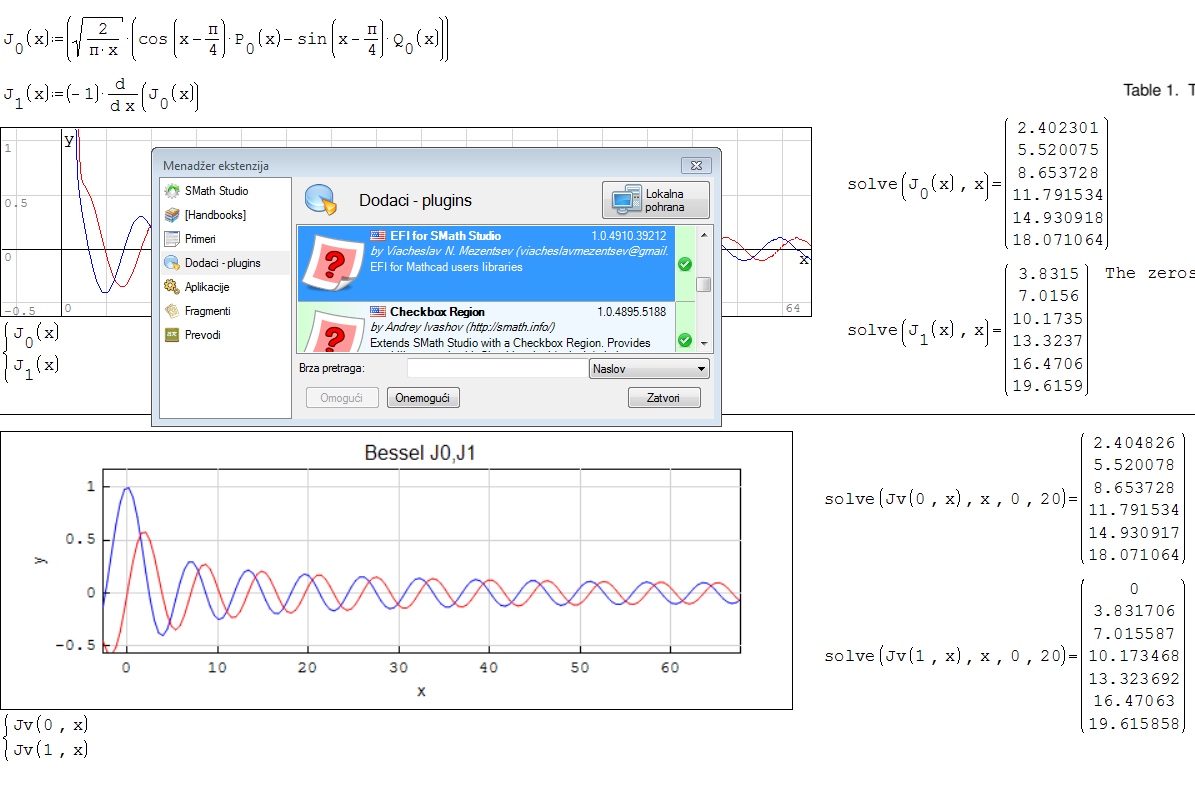

It seems I had a lucky guess this time. I've seen the EFI plugin in the Gallery. Installed it first and then copied the mathlib.dll in the place you mentioned. Bessel and other functions are back . Here is the result using the file by AlphaBeta. By the way, this much faster than using the approximation formulae.
Huh...this was a bit complicated
It appeared that the more complicated become to follow the functions, their plugins etc. Once more to say, that there must be a way to see where the functions came from. Again, "all" category become overcrowded. Is there any way that for one of the next release the function category be devided into the external plugins and their accompanied functions?

Originally the library (and demo) was intended for Mathcad, where such functions are present.
It is strange that it works in Linux. I thought this plugin in Linux will not work.

uni, it is not linux but windows, running the mono build

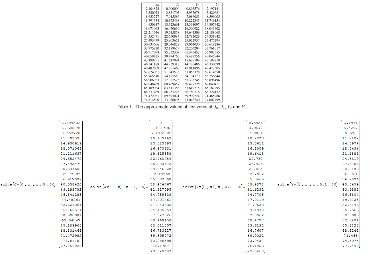

But nevertheless attached you can find my "home-brew"-approach towards the Bessel function.
Actually I only wanted to solve a heat transfer problem.

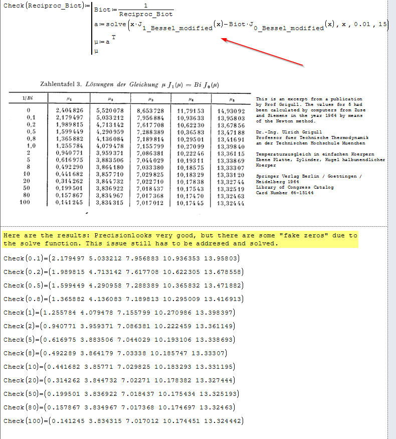

20130612 Bessel Modified.sm (1023.6 KiB) downloaded 1112 time(s).
#15 Posted: 2013/6/12 13:30:09
The results from solve() depends on the equation, range and decimal places (Tools|Options|Calculation Decimal places). See the result if you change the equation, give different range and set 15 decimal places.

Hello Radovan,
thank you for your hint. I know that the solve function will produce some "ghost-zeros" in certain cases depending on the function, the range and the precision. I have sorted this out before by means of a little program within SMath using BiSection or NewtonRaphson, or using the initial zeros and then making a second, more refined "solve"-run using closer ranges. Additional knowledge about the functions periodicy is also helpful here.
Yesterday I was happy that it at least does work in principal now. ( The last Bessel function I have seen was 25 years ago)
But generally spoken, wouldn't it be a dream to have a clever solve algorithm which does such things automatically?
(I know that trying this is absolutely no simple endeavor. Multiple strategies and various algorithms would have to be employed depending on the current situation at hand...)

By the way, increasing the precision in the program setting did not improve the situation.
But of course narrowing the range does remedy the situation. But such things need to be done "manually" and with knowledge about the function.
