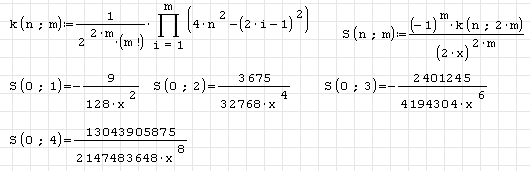

A lot of much more clever people than me have found ways to approximatley decribe the Bessel functions in a more "computer-friendly" way by using ploynoms for example.
A very good solution I have found is from John Harris, Intel. So I decided to use his approach.
(see attachment). It is working very well so far, but now I want to increase the precision a liitle bit by adding one or 2 summands to his P and Q polynoms (see attachment) But unfortunately I don't fully understand his notation form not even though he is describing it. (sse attachment)
Is there anybody who could help me with that?
Later I will contribute the calculation of non-stady state heat transfer problems, acc. the boundary conditions of the third kind for simple bodies like plate, cylinder, and sphere.
Thank you veryvery much in advance. (The problem is described in the attachment very clearly.)

Try this. I just literally defined the functions and it seems to work.

you have saved my day. Thank you very very much.
Now I also can understand the notation. I really got stuck here before.

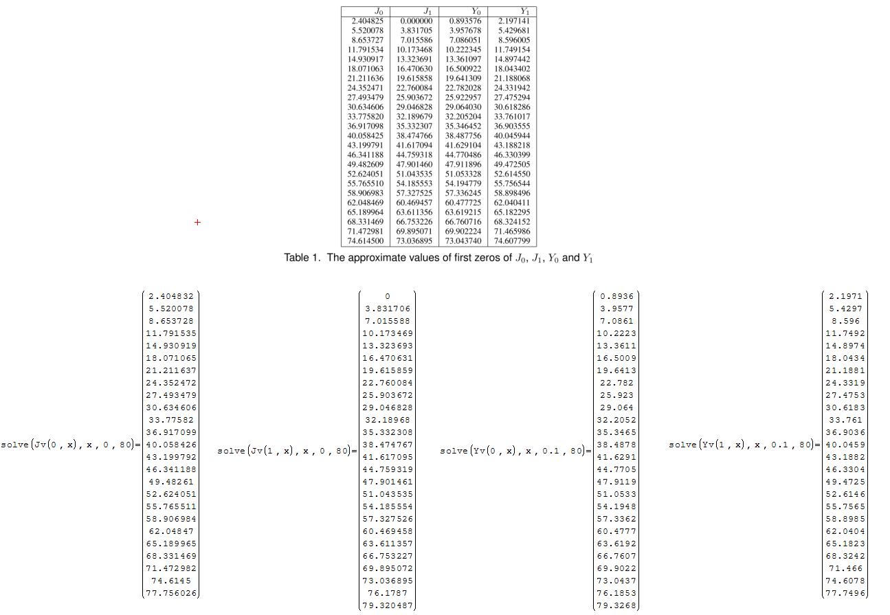

Yes, there is a plugin which includes those special functions (Bessel, Modified Bessel, Integral functions etc.). Mathcad EFI made by uni. I was using them in my teaching few times. Unfortunately, the plugin is not working with the most recent SMath version. I hope that uni will find the way to recompile and put it in the Online Gallery, or expand the existing Alglib in order to include Bessel functions as well.
#5 Опубликовано: 11.06.2013 11:52:17
First: Is there any plugin or function in SMath Studio for Bessel functions?
(Maybe not, at least I didn't find such a thing anywhere.
Done. You must manually copy the mathlib.dll to the userefi folder (".../Application Data/.../91a20d24-c30b-4774-9b1b-4d502a80420f/x.x.x.x/userefi/" ).
mathlib.sm (59,64 КиБ) скачан 1254 раз(а).

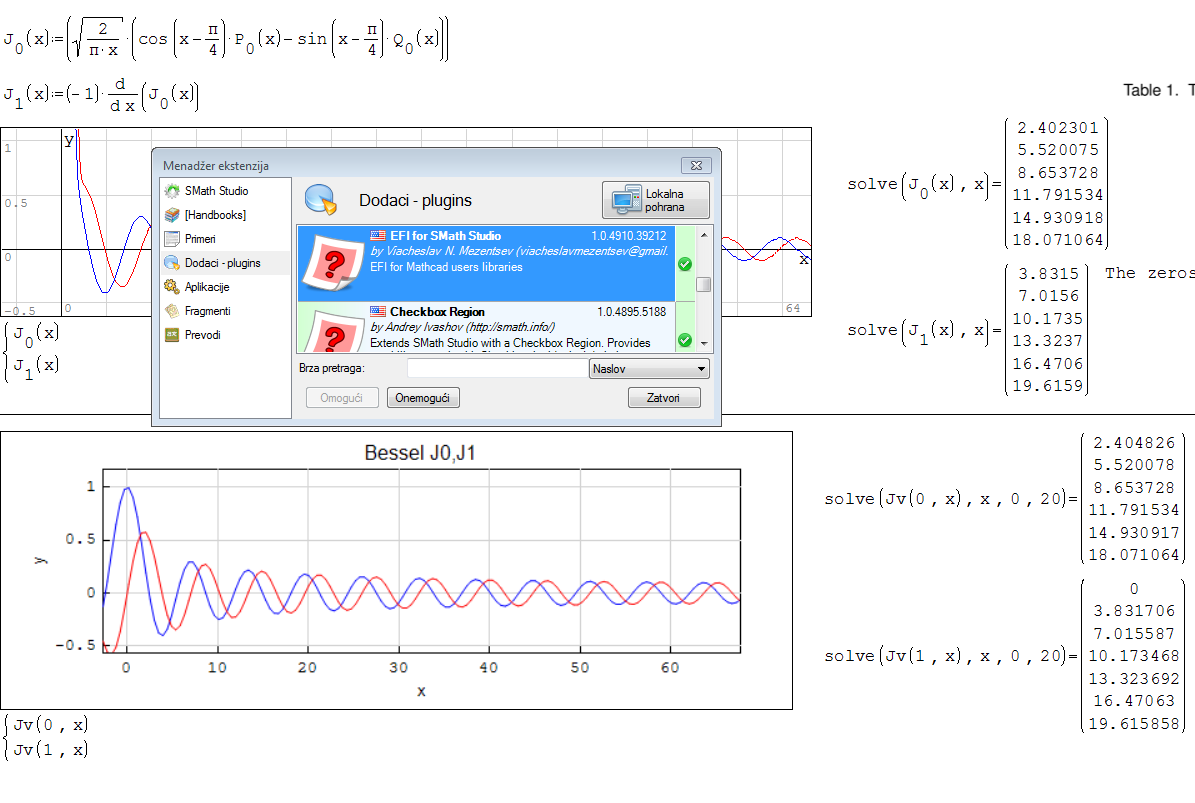

Thank you uni
It seems I had a lucky guess this time. I've seen the EFI plugin in the Gallery. Installed it first and then copied the mathlib.dll in the place you mentioned. Bessel and other functions are back . Here is the result using the file by AlphaBeta. By the way, this much faster than using the approximation formulae.
Huh...this was a bit complicated
It appeared that the more complicated become to follow the functions, their plugins etc. Once more to say, that there must be a way to see where the functions came from. Again, "all" category become overcrowded. Is there any way that for one of the next release the function category be devided into the external plugins and their accompanied functions?

ok done but afterwards i've tried the sample with the last mono version, it says "function is not defined" for In and Jn functions
#10 Опубликовано: 11.06.2013 15:51:36
Did you mean on Bessel functions by In,Jn ? Their names are actually Iv, Jv.

it may not have importance. I haven't looked well the sample. See this video:
http://screencast-o-matic.com/watch/cI1XqFVwTX
#12 Опубликовано: 11.06.2013 16:15:46
Originally the library (and demo) was intended for Mathcad, where such functions are present.
It is strange that it works in Linux. I thought this plugin in Linux will not work.

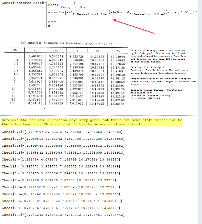

But nevertheless attached you can find my "home-brew"-approach towards the Bessel function.
Actually I only wanted to solve a heat transfer problem.
Now I am a litte bit
Also thanks to M. Kraska.
20130612 Bessel Modified.sm (1023,6 КиБ) скачан 1301 раз(а).
#15 Опубликовано: 12.06.2013 13:30:09
The results from solve() depends on the equation, range and decimal places (Tools|Options|Calculation Decimal places). See the result if you change the equation, give different range and set 15 decimal places.

thank you for your hint. I know that the solve function will produce some "ghost-zeros" in certain cases depending on the function, the range and the precision. I have sorted this out before by means of a little program within SMath using BiSection or NewtonRaphson, or using the initial zeros and then making a second, more refined "solve"-run using closer ranges. Additional knowledge about the functions periodicy is also helpful here.
