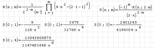

(see attachment). It is working very well so far, but now I want to increase the precision a liitle bit by adding one or 2 summands to his P and Q polynoms (see attachment) But unfortunately I don't fully understand his notation form not even though he is describing it. (sse attachment)

Try this. I just literally defined the functions and it seems to work.

Dear mKraska,
you have saved my day. Thank you very very much.
Now I also can understand the notation. I really got stuck here before.

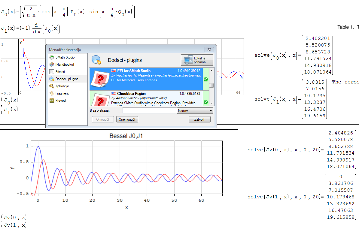

Yes, there is a plugin which includes those special functions (Bessel, Modified Bessel, Integral functions etc.). Mathcad EFI made by uni. I was using them in my teaching few times. Unfortunately, the plugin is not working with the most recent SMath version. I hope that uni will find the way to recompile and put it in the Online Gallery, or expand the existing Alglib in order to include Bessel functions as well.

Done. You must manually copy the mathlib.dll to the userefi folder (".../Application Data/.../91a20d24-c30b-4774-9b1b-4d502a80420f/x.x.x.x/userefi/" ).

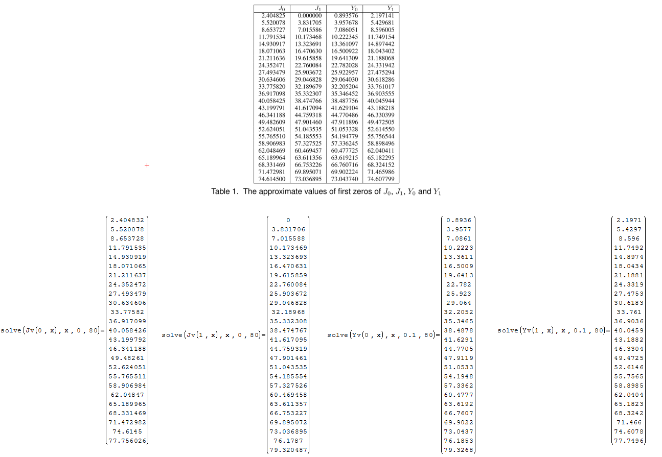

It seems I had a lucky guess this time. I've seen the EFI plugin in the Gallery. Installed it first and then copied the mathlib.dll in the place you mentioned. Bessel and other functions are back . Here is the result using the file by AlphaBeta. By the way, this much faster than using the approximation formulae.
Huh...this was a bit complicated
It appeared that the more complicated become to follow the functions, their plugins etc. Once more to say, that there must be a way to see where the functions came from. Again, "all" category become overcrowded. Is there any way that for one of the next release the function category be devided into the external plugins and their accompanied functions?

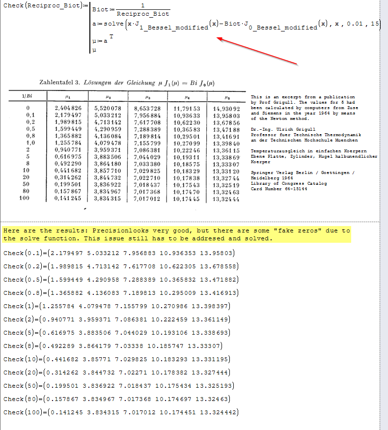

The results from solve() depends on the equation, range and decimal places (Tools|Options|Calculation Decimal places). See the result if you change the equation, give different range and set 15 decimal places.
#16 Posted: 6/12/2013 11:03:51 PM

thank you for your hint. I know that the solve function will produce some "ghost-zeros" in certain cases depending on the function, the range and the precision. I have sorted this out before by means of a little program within SMath using BiSection or NewtonRaphson, or using the initial zeros and then making a second, more refined "solve"-run using closer ranges. Additional knowledge about the functions periodicy is also helpful here.
Yesterday I was happy that it at least does work in principal now. ( The last Bessel function I have seen was 25 years ago)
