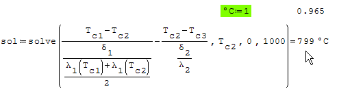

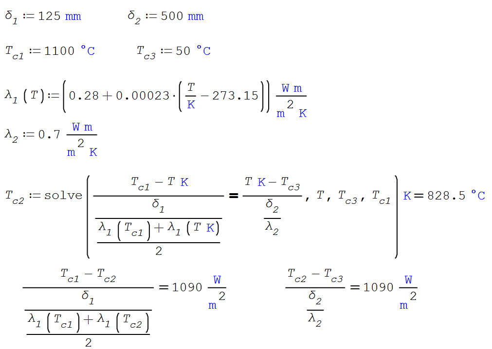

Solve & Roots - Mathcad OK, SMath not OK - Messages
WroteWhy no solution?
Units?
With Roots and without units - OK!
Krasnoshchekov-Sukomel-10-10.sm (209.72 KiB) downloaded 1242 time(s).

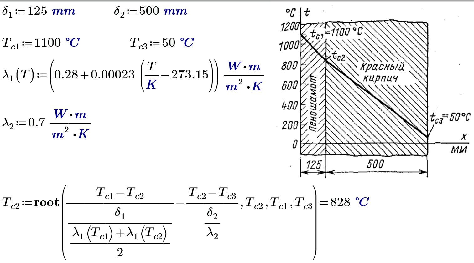

Wroteroot is undocumented in Smath. However, we have applications.

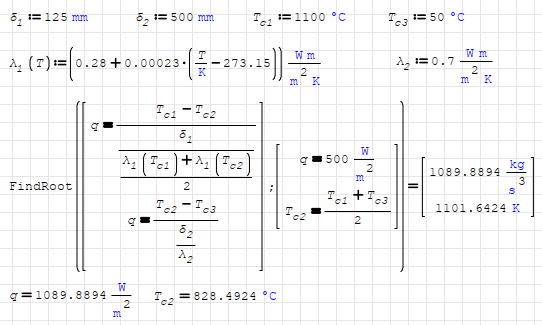

Solve Inverse [Seeded Scanner QUICK TRACK] Copy.sm (150.91 KiB) downloaded 1040 time(s).

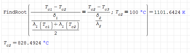

WroteSend please the SMath file!
Krasnoshchekov-Sukomel-10-10_findroot.sm (206.95 KiB) downloaded 1257 time(s).

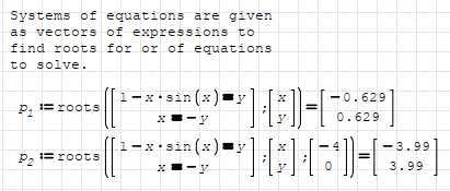

WroteCan we do it with the roots function with 2 or more equations and unknowns?
Please, attach a document to evaluate the request.
WroteWroteCan we do it with the roots function with 2 or more equations and unknowns?
Sorry, done myself.
Krasnoshchekov-Sukomel-Alan.sm (13.42 KiB) downloaded 1242 time(s).
