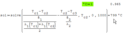

#1 Posted: 5/22/2023 7:30:56 AM
Valery Ochkov
Valery Ochkov
66 likes in 690 posts.

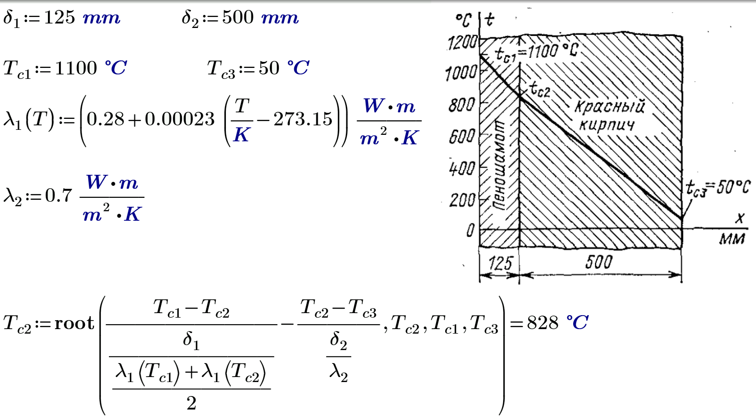

Why no solution?
Units?
Krasnoshchekov-Sukomel-10-10.sm (203.8 KiB) downloaded 1300 time(s).

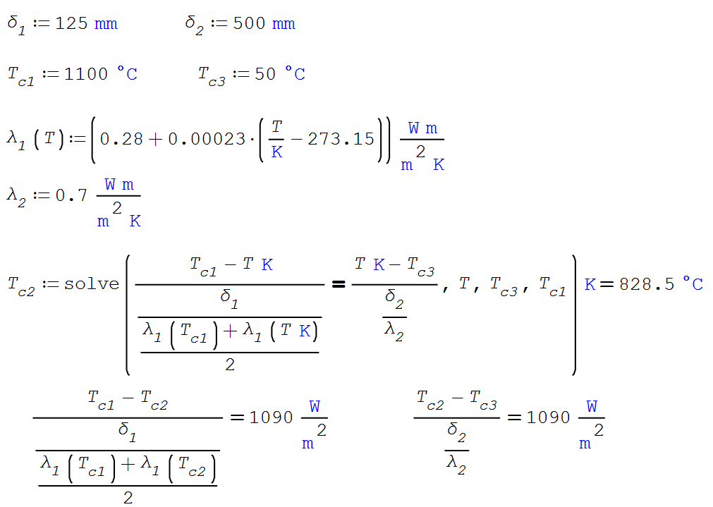

#2 Posted: 5/22/2023 8:10:47 AM
Valery Ochkov
Valery Ochkov
Why no solution?
Units?
With Roots and without units - OK!
Krasnoshchekov-Sukomel-10-10.sm (209.72 KiB) downloaded 1276 time(s).
#3 Posted: 5/22/2023 9:10:10 AM
Why no solution ? ... Units ?
If you disable Units, you have a solution.
root is undocumented in Smath. However, we have applications.
Mathcad root is known to be inaccurate.

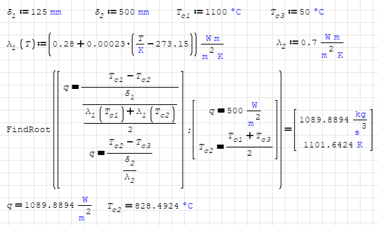

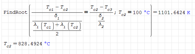

#5 Posted: 5/22/2023 12:51:11 PM
598 likes in 1,380 posts.
Use Findroot() for solving with units.
And your λ.2 part was different from original document.

#7 Posted: 5/22/2023 5:55:55 PM
Send please the SMath file!
Krasnoshchekov-Sukomel-10-10_findroot.sm (206.95 KiB) downloaded 1283 time(s).

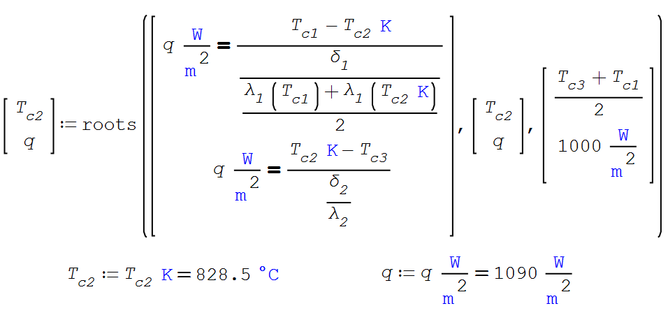

Can we do it with the Roots function with 2 or more equations and unknowns?

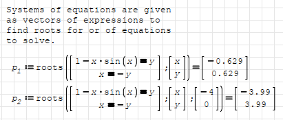

#12 Posted: 5/23/2023 11:05:22 AM
Yes you can.
With inserting units, roots() can solve as solve() function.
roots() and Findroot() are both capable of solving system of equations.
Findroot() can solve without inserting units.
Can we do it with the roots function with 2 or more equations and unknowns?
Please, attach a document to evaluate the request.
Sorry, done myself.
Krasnoshchekov-Sukomel-Alan.sm (13.42 KiB) downloaded 1275 time(s).
#14 Posted: 5/23/2023 4:46:53 PM
Sorry, done myself.
Here is an alternate way to solve your variables.
