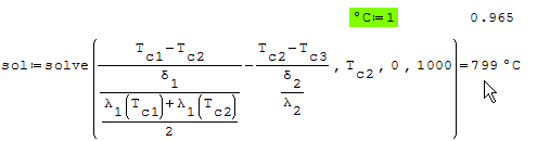

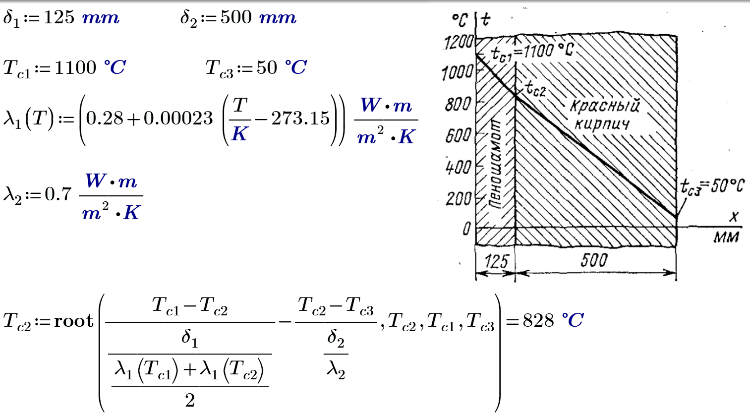

Why no solution?
Units?
Krasnoshchekov-Sukomel-10-10.sm (203,8 КиБ) скачан 1267 раз(а).

Why no solution?
Units?
With Roots and without units - OK!
Krasnoshchekov-Sukomel-10-10.sm (209,72 КиБ) скачан 1239 раз(а).
#3 Опубликовано: 22.05.2023 09:10:10
Why no solution ? ... Units ?
If you disable Units, you have a solution.
root is undocumented in Smath. However, we have applications.
Mathcad root is known to be inaccurate.

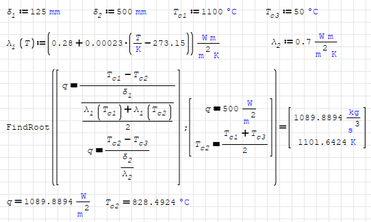

#5 Опубликовано: 22.05.2023 12:51:11
598 сообщений из 1 379 понравились пользователям.

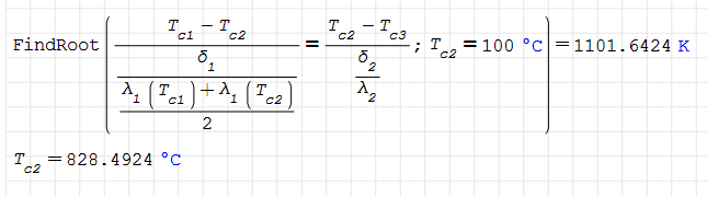

Use Findroot() for solving with units.
And your λ.2 part was different from original document.
Valery Ochkov 22.05.2023 13:17:00
#6 Опубликовано: 22.05.2023 13:17:54
Valery Ochkov
Valery Ochkov
66 сообщений из 690 понравились пользователям.
Send please the SMath file!
#7 Опубликовано: 22.05.2023 17:55:55
Krasnoshchekov-Sukomel-10-10_findroot.sm (206,95 КиБ) скачан 1253 раз(а).

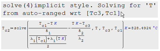

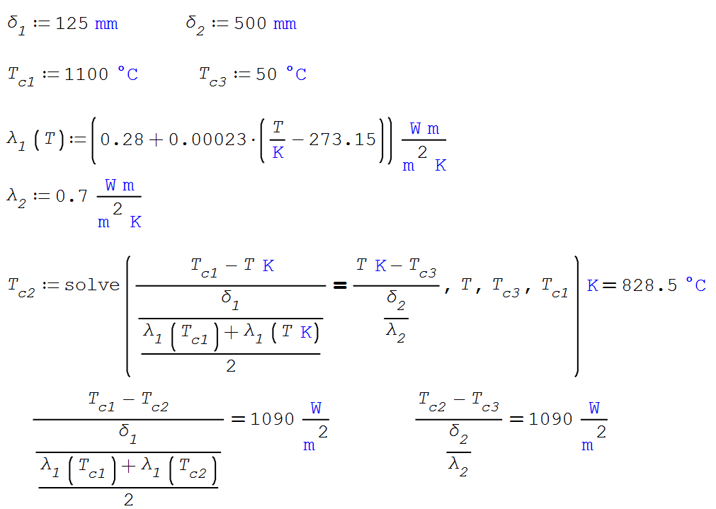

Solution from Alan Stevens
Krasnoshchekov-Sukomel-Alan.sm (206,24 КиБ) скачан 1230 раз(а).
#9 Опубликовано: 23.05.2023 09:34:25
Brilliant solution ... Thanks Valery

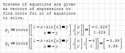

Can we do it with the Roots function with 2 or more equations and unknowns?
#11 Опубликовано: 23.05.2023 10:52:57
Can we do it with the roots function with 2 or more equations and unknowns?
Please, attach a document to evaluate the request.
#12 Опубликовано: 23.05.2023 11:05:22
Yes you can.
With inserting units, roots() can solve as solve() function.
roots() and Findroot() are both capable of solving system of equations.
Findroot() can solve without inserting units.

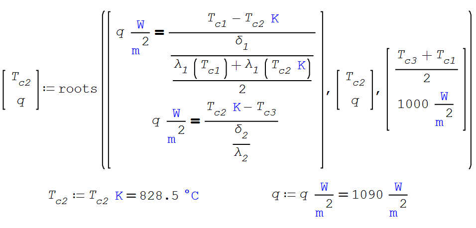

#14 Опубликовано: 23.05.2023 16:46:53
Sorry, done myself.
Here is an alternate way to solve your variables.
