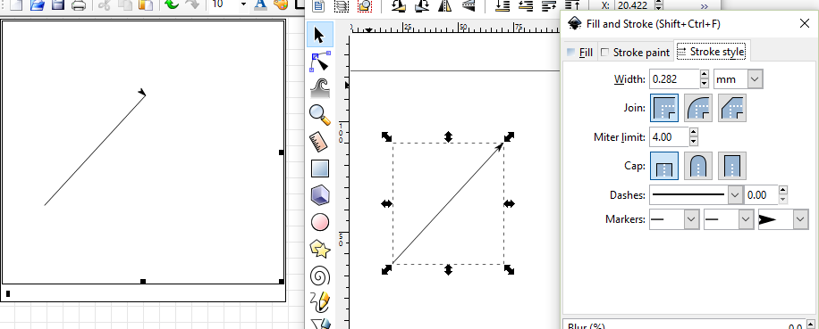

Also I am getting close to the point where I wanted to be for the Image Region development (once I take care of the above, if it proves to be possible / necessary). Do you guys have any major griefs with it, or suggestions? Otherwise I wil wrap it up and publish to the extensions manager.
I am not sure if this counts as major grief, but here is screenshot where displayed stroke style is different from what was intended in inksape.
#63 Posted: 2016/2/4 00:54:57
____________________ certainly very annoying:
... missing closure in Inkscape ? ... problem saving from Inkscape ?
... Smath not reading correct ? [doubtful]
Read more: once the object is imported in the image region,
"Reset to original size" ... stretch the right handle to create space.
At this point, if you want to zomm ± : move the bottom handle up/down,
that procedure will respect the "Aspect ratio". I have checked the Smath
image zoom with IrfanView: for photos they are ~ equal quality.

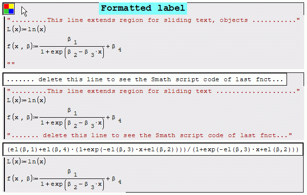

The last brick in the wall about editable region(s) is the "Formatted Label".
Possibly useful for collecting functions of same family, vg: PDF, CDF ...

This release addresses all the issues below.
Not resolved:
1. Rendering of inkscape arrows. Even though I am using new SVG renderer, the arrow is still off - now it is reversed. On a plus side - arrow on the left end of line points correctly - use that one.
2. image border on init - proved to be much trouble for the amount of benefit.
Otherwise it is smooth sailing so far. All that is left from what I would like to implement is two new formats: .psd (work with layers) and .dxf (hugely beneficial from engineering perspective).
Cheers all!

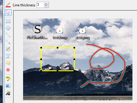

I need .psd to simplify stetching on top of existing blueprints / drawings - one layer - existing drawing, another - my freehand stuff.
Not sure if this is easier but I think a good approach may be to replicate what is possible to do with the image editor of greenshot. Any sketch may be treated as an object of the region (like a layer) drawn over the background. Part of the code may be taken from the modeller region. Just an idea.

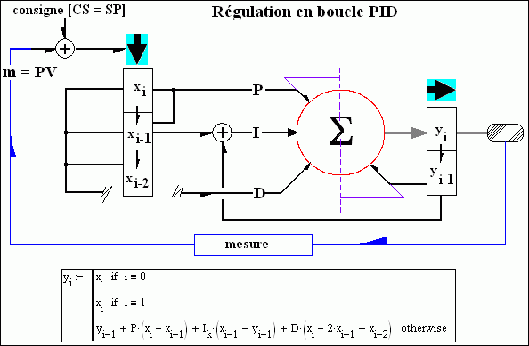

Smath imports from my file folder plots as nice as
the *.BMP 24 BPP. The gain in size is immense, by
wisely graphing and wisely saving, job done ...
No need for Inksacpe, CorelDraw, ... else invention.
