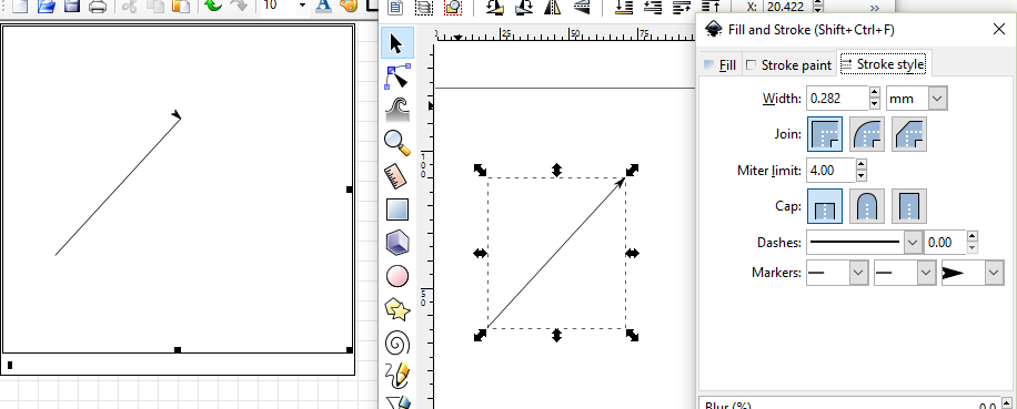

I am not sure if this counts as major grief, but here is screenshot where displayed stroke style is different from what was intended in inksape.
____________________ certainly very annoying:
... missing closure in Inkscape ? ... problem saving from Inkscape ?
... Smath not reading correct ? [doubtful]
Read more: once the object is imported in the image region,
"Reset to original size" ... stretch the right handle to create space.
At this point, if you want to zomm ± : move the bottom handle up/down,
that procedure will respect the "Aspect ratio". I have checked the Smath
image zoom with IrfanView: for photos they are ~ equal quality.

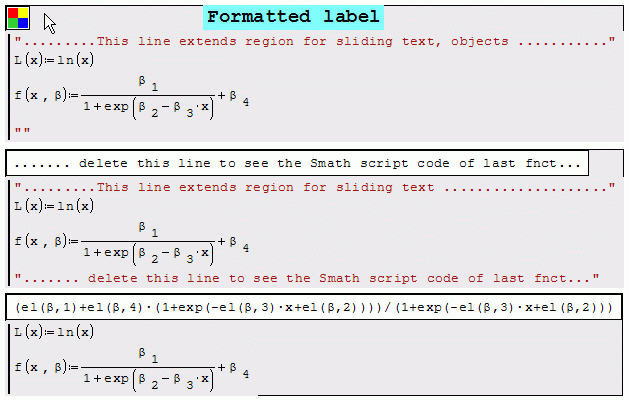

The last brick in the wall about editable region(s) is the "Formatted Label".
Possibly useful for collecting functions of same family, vg: PDF, CDF ...

1. Rendering of inkscape arrows. Even though I am using new SVG renderer, the arrow is still off - now it is reversed. On a plus side - arrow on the left end of line points correctly - use that one.

I've got a question related to SVG page size and image size.
In order to keep line thickness, arrow sizes, symbols and the like consistent in a document, I would like to be able to reset the zoom level of an svg image to that one which is used upon init of a new region.
For png, this is done by "reset to original size", for svg this does not work.
So far, the only option to keep the scale consistent, is to always use new image regions (not copies or clones) for new images and to never resize them.
I guess that the svg images somehow maintain a record of their page size, otherwise it would not be known to inkscape. Could that be used to resize the image region to the original scale?
How do you handle this issue?
This was fixed in the attached. Keep in mind that re-rendering of SVG only on click or evaluation is not a bug - it speeds up resizing

Thanks again for the update. Now it is possible to restore the region size of svg images after changing it in SMath.
But if the paper size is changed in Inkscape, the region doesn't recognize this. At least you can't reset it to a size reflecting the changed values.
Maybe, it is an option, to change the paper size in inkscape to the actual region size whenever inkscape is called? Don't know what side effects this might have but changing the papersize in inkscape seems to be cumbersome and the proposed procedure would be very easy to handle. You would always see in inkscape, what the original size of your region would be.

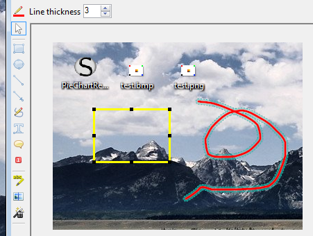

EDIT
You can define a private bool Resizing -> OnMouseDown: set it true if you are over the resize markers -> OnMouseUp: if is true trigger the re-rendering and set it to false;
