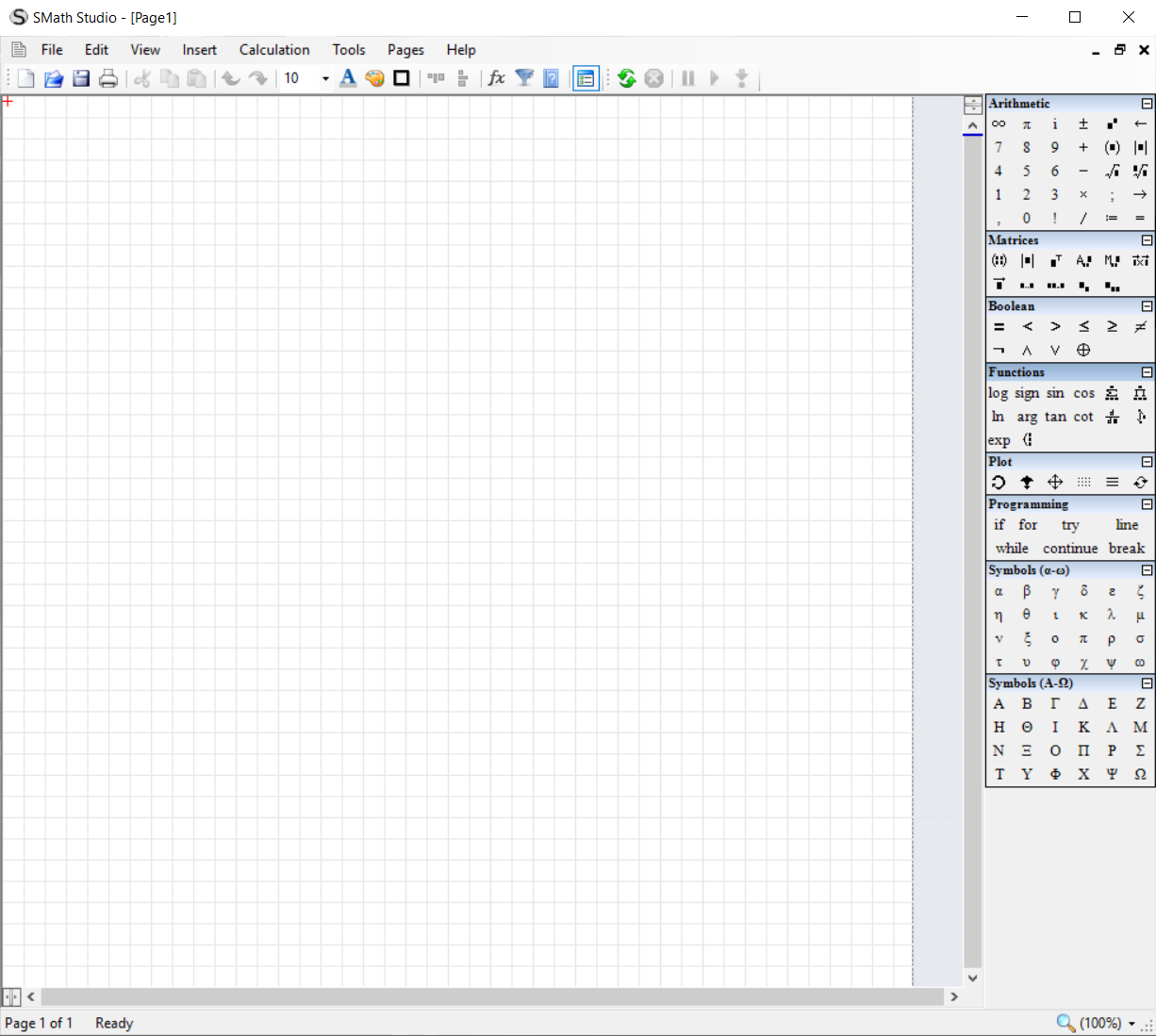

I don't know what is happening but it seems image plugin is ruining the integrity of Smath Studio
I am using Nvidia GTX 1070 with 2560x1440 resolution and 125% text on Windows 10 if it will helps.
Without Plugin everything seems normal,
When I install the plugin the Smath Studio got crazy.
#110 Posted: 2017/2/20 19:34:42

I have never said image region is not working, it just scrambles the Smath (6179) window with my Windows 10 display settings.
You can see that on the screenshot below too. Everything is fine if I remove Image Region.

Issues are are form's fonts changed, desktop background visible through the window and these. I'll see if I can help Alex, as pointed out the issues are related to windows 10 only.
