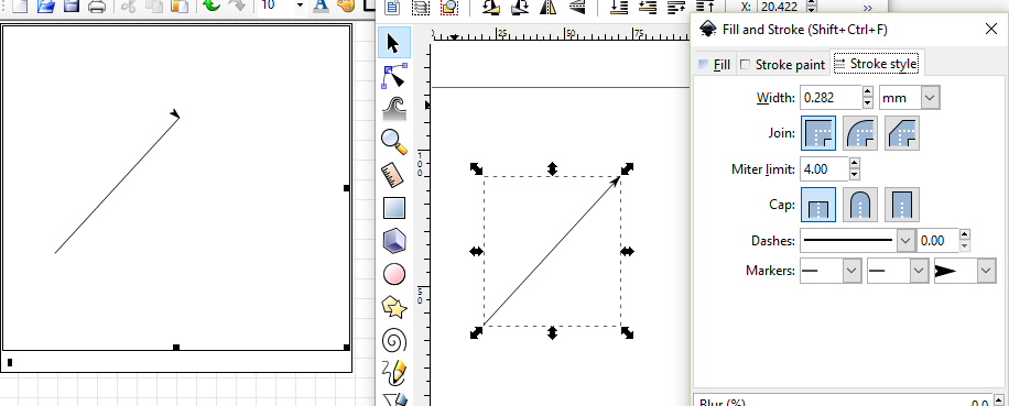

Also I am getting close to the point where I wanted to be for the Image Region development (once I take care of the above, if it proves to be possible / necessary). Do you guys have any major griefs with it, or suggestions? Otherwise I wil wrap it up and publish to the extensions manager.
I am not sure if this counts as major grief, but here is screenshot where displayed stroke style is different from what was intended in inksape.
____________________ certainly very annoying:
... missing closure in Inkscape ? ... problem saving from Inkscape ?
... Smath not reading correct ? [doubtful]

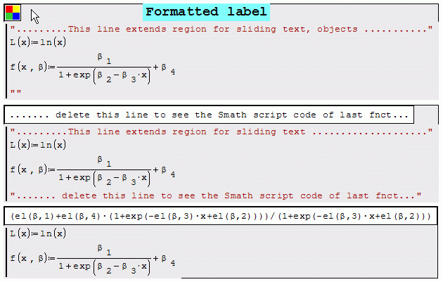

The last brick in the wall about editable region(s) is the "Formatted Label".
Possibly useful for collecting functions of same family, vg: PDF, CDF ...

1. Rendering of inkscape arrows. Even though I am using new SVG renderer, the arrow is still off - now it is reversed. On a plus side - arrow on the left end of line points correctly - use that one.

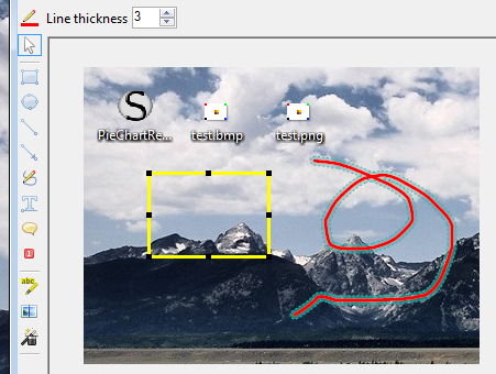

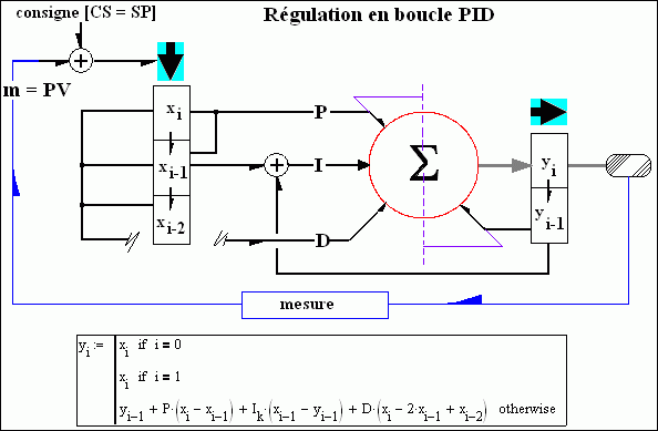

IMHO, I don't understand why sticking with Inkscape that is just a gadget.
Doing something with CorelDraw, AutoCad ... would make more sense to me.
Most [if not all] Inkscape is doing, is done in Mathcad "Creating Amazing Images"
This Handbook is huge, 10MB. My point here is an "SmathDraw" version as another
product ... in competition with Industry established standard.
PTC, "ProEngineer, Winchill" is great stuff.
Smath does not manage large size matrix, consequently the image region,
Proof: The first Inkscape that Martin posted, the image region does
replot in parts only, not entirely. That's why I posted a scaled down
version that reproduces completely. And, Martin orignal Inkscape is
a peanut size graphic for whoever would want doing some project.
Assume all the Inkscape dedication is successful, fine. But Smath does
not have a 3D graphic to render. It does not plot/rotate 3D matrix,
it only renders as image of limited size.

load in the Forum attachment. The *.gif is 4 BPP,
Smath imports from my file folder plots as nice as
the *.BMP 24 BPP. The gain in size is immense, by
wisely graphing and wisely saving, job done ...
No need for Inksacpe, CorelDraw, ... else invention.
