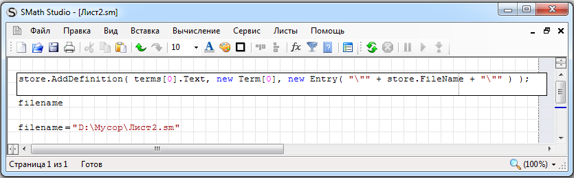

As workaround you can use simple C# script for this (Script plugin).
store.AddDefinition( terms[0].Text, new Term[0], new Entry( "\"" + store.FileName + "\"" ) );

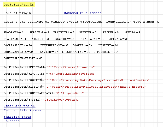

The function getfolderpath() seems to be broken for build 7219:
getfolder.sm (2.21 KiB) downloaded 963 time(s).
