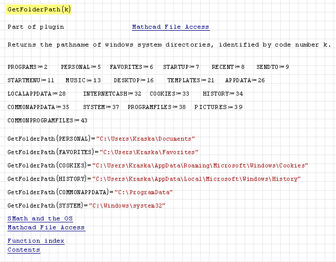

1,361 likes in 2,275 posts.
Perhaps the function GetFolderPath() can help.

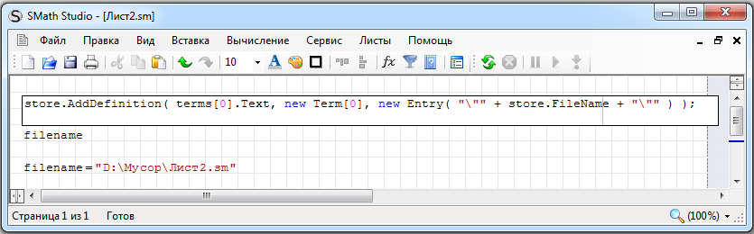

Is there a function that returns the filename of the current worksheet/Smath Document? I couldn't find it
Currently I have the same question and also no answer (and couldn't find one).
Can anybody help?

Is there a function that returns the filename of the current worksheet/Smath Document?I couldn't find it
path:=CurrentDirectory("")
path="C:\Smath6179\"
Hi Jean,
I do know 'CurrentDirectory( "" )' but it returns the path without the filename. And I am trying to retrieve the latter.

#34 Posted: 6/8/2017 9:05:42 AM
1,558 likes in 1,868 posts.
This is as good a place as any:
Can anybody help?
As workaround you can use simple C# script for this (Script plugin).
store.AddDefinition( terms[0].Text, new Term[0], new Entry( "\"" + store.FileName + "\"" ) );

#36 Posted: 10/29/2019 5:05:48 AM
The function getfolderpath() seems to be broken for build 7219:
getfolder.sm (2.21 KiB) downloaded 1781 time(s).
