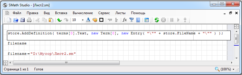

Is there a function that returns the filename of the current worksheet/Smath Document? I couldn't find it

Currently I have the same question and also no answer (and couldn't find one).
Can anybody help?

As workaround you can use simple C# script for this (Script plugin).
store.AddDefinition( terms[0].Text, new Term[0], new Entry( "\"" + store.FileName + "\"" ) );

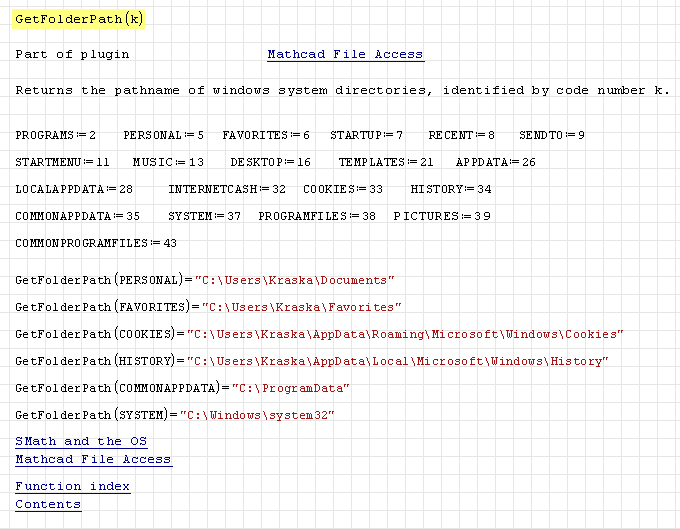

The function getfolderpath() seems to be broken for build 7219:
getfolder.sm (2,21 КиБ) скачан 1781 раз(а).
![2019-10-29 07_52_04-SMath Studio 0.99.7219 - [Blatt5_].png](/ru-RU/files/Download/spgdML/2019-10-29-07_52_04-SMath-Studio-0.99.7219---[Blatt5_].png)
