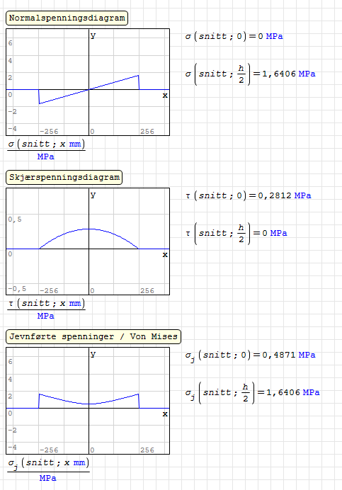

Seeing how fast I got great and helpful answers yesterday, I thought I might ask another rather silly question. I am trying to animate a plot, and I have never done it before.
I have made a simple sheet ploting V,M for a rectangular simply supported beam with uniformly distributed load. I have also plotted sigma and tau for the section, as well as Von Mises.
I have tried to make 3D plots to show how stresses evovle through the length of the beam, and to some extent it illustrates that.
I have also tried to animate a 2D plot, to work like a cross section that moves along the length of the beam, but I cannot figure out how to make it work.
Any ideas where it went wrong for me?
Also; is it possible to plot stresses along y-axis as opposed to x-axis?
Thanks again :d
spenninger bjelke.sm (30.46 KiB) downloaded 1056 time(s).

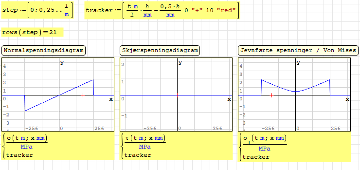

Well, I got the animations to work. I guess the mistake was to try to animate on a variable named 't'.
With a bit more tinkering I should be able to plot my stresses about y-y axis as well.
Best regards,
Hans Kristian
spenninger bjelke.sm (32.03 KiB) downloaded 1067 time(s).

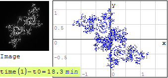

I find it somewhat funny my simple stress visualization sheet was something you deemed worthy of saving on your harddrive.
It carries units so nicely, not usual vs so many projects
that fail [Units don't match].
The attach breakfast with chicken rather than eggs.
At least, my small laptop does not smoke.
Pattern Julia Set [PUBLISH].sm (25.09 KiB) downloaded 817 time(s).
Thank you!
Mine actually managed this sheet in 1.2 minutes.. :d

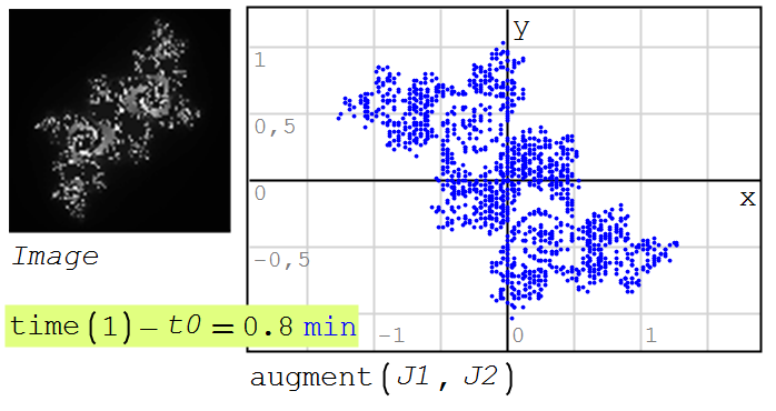

0.8 min using latest 7251:
Significant (20x) performance improvement for 3 years.
#15 Posted: 2019/11/8 21:42:22
Impressive improvement ... MCD 11 XP Pro [4 sec]
Thanks Andrey ... Jean
