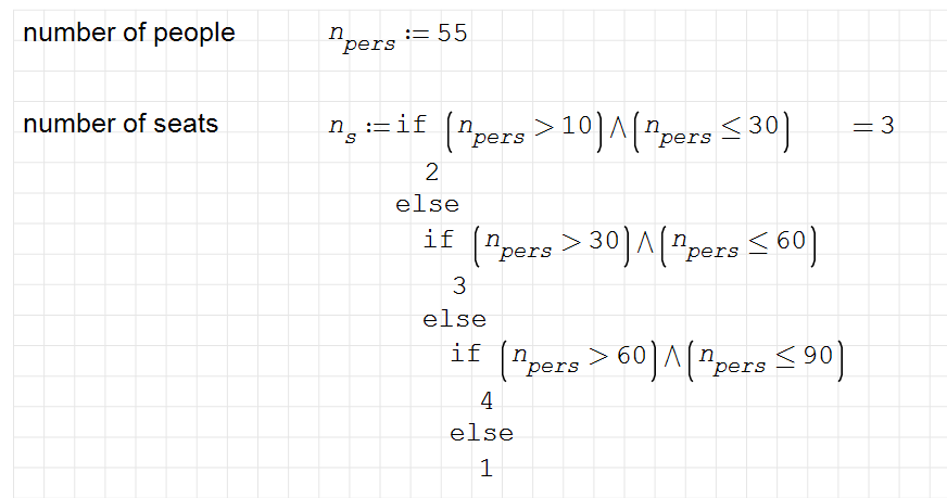

Hi to everyone, I'm a new user of S-math.
I'm a newbie to programming.
Today I had to make a calculation to size the number of seats in a waiting room according to the total number of people.
The number of seats must be 1 for every 30 people.
I tried to make the calculation automatic via S-math, but I was unable. I thought the for loop might help me, but I don't know how. Can someone help me?

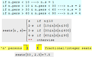

Hi I try to explain better what I want to calculate.
I would like to set up a for loop that allows me to do the same calculations as the if loop in the figure.
for example
if n.pers < 10 ---> n.s = 1
if n.pers > 10 & n.pers < 30 ---> n.s = 2
if n.pers > 30 & n.pers < 60 ---> n.s = 3
if n.pers > 60 & n.pers < 90 ---> n.s = 4
and so on
I don't know how if it's possible set up this cycle, anyway thanks.

You don't need an iteration.
Ceil() and cases() shall work for you.

Hi
I'm probably doing something wrong because, for exemple, with 40 or 70 it doesn't work.
#7 Posted: 2021/10/12 14:38:28
598 likes in 1,380 posts.
Hi
Probably, please use the file below.
seats.sm (2.79 KiB) downloaded 1040 time(s).

The suggestion of Overlord is correct. You can also define a function and make different corresponding values ​​calculate (using the Vectorize function)
number_seat.sm (6.94 KiB) downloaded 1122 time(s).

I used an old version. Now work correctly in my pc, too.
