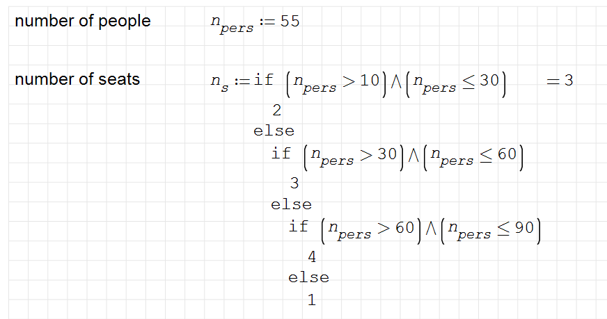

#4 Posted: 10/12/2021 1:19:00 PM
talpacolore
talpacolore
0 likes in 4 posts.
Hi I try to explain better what I want to calculate.
I would like to set up a for loop that allows me to do the same calculations as the if loop in the figure.
for example
if n.pers < 10 ---> n.s = 1
if n.pers > 10 & n.pers < 30 ---> n.s = 2
if n.pers > 30 & n.pers < 60 ---> n.s = 3
if n.pers > 60 & n.pers < 90 ---> n.s = 4
and so on
I don't know how if it's possible set up this cycle, anyway thanks.

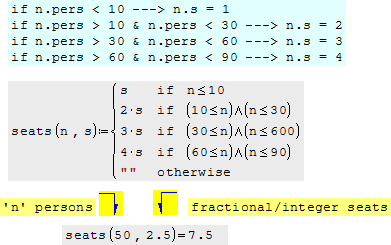

#6 Posted: 10/12/2021 2:29:11 PM
talpacolore
talpacolore
0 likes in 4 posts.
Hi
I'm probably doing something wrong because, for exemple, with 40 or 70 it doesn't work.
#7 Posted: 10/12/2021 2:38:28 PM
599 likes in 1,380 posts.
Hi
Probably, please use the file below.
seats.sm (2.79 KiB) downloaded 1188 time(s).

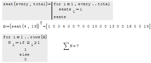

#8 Posted: 10/12/2021 2:50:02 PM
127 likes in 342 posts.
The suggestion of Overlord is correct. You can also define a function and make different corresponding values ​​calculate (using the Vectorize function)
number_seat.sm (6.94 KiB) downloaded 1256 time(s).
