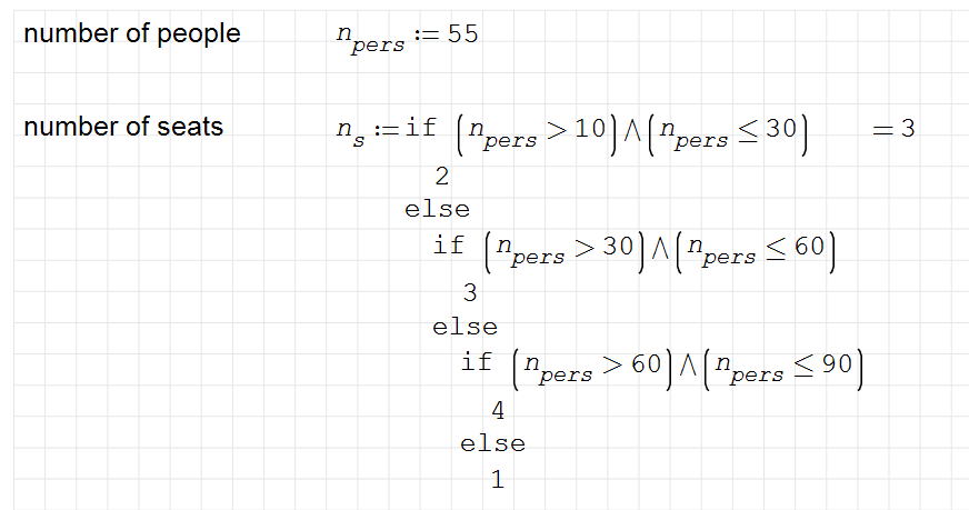

Hi I try to explain better what I want to calculate.
I would like to set up a for loop that allows me to do the same calculations as the if loop in the figure.
for example
if n.pers < 10 ---> n.s = 1
if n.pers > 10 & n.pers < 30 ---> n.s = 2
if n.pers > 30 & n.pers < 60 ---> n.s = 3
if n.pers > 60 & n.pers < 90 ---> n.s = 4
and so on
I don't know how if it's possible set up this cycle, anyway thanks.

You don't need an iteration.
Ceil() and cases() shall work for you.

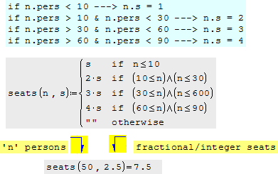

#8 Опубликовано: 12.10.2021 14:50:02
The suggestion of Overlord is correct. You can also define a function and make different corresponding values ​​calculate (using the Vectorize function)
number_seat.sm (6,94 КиБ) скачан 1256 раз(а).

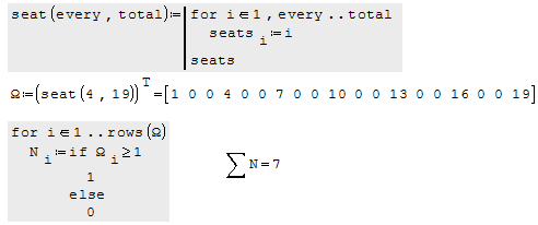

You can elongate at will:
1. collect the last condition from RHS
2. double coma
