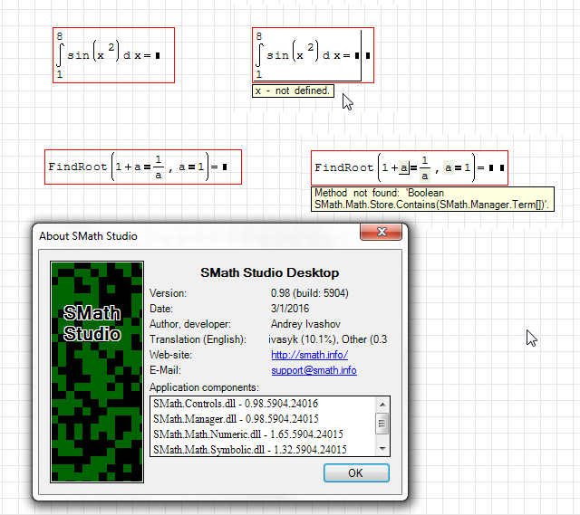

However, fresh install with only Davide's Nonlinear Solvers (FindRoot() function is from there) and Martin's Smath Handbook will give this
1. FindRoot() will give the same error as on the picture
2. Definite integral works
Davide Carpi 2016/3/2 09:39:00

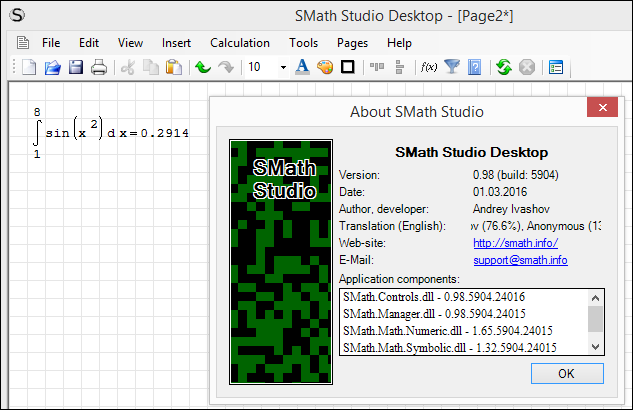

#13 Posted: 2016/3/2 09:35:30
1,443 likes in 2,935 posts.
NonlinearSolvers updated, try now
I have no problems with integrals, no exceptions in the files above (Reservoir Flood Capacity Estimation-R1 / TestSum).
Andrey Ivashov 2016/3/2 10:29:00

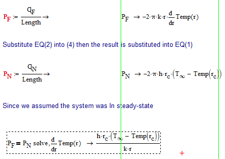

...Any information on the symbolics? I am trying to recreate a "proof" from a Mathcad file and I'm missing some features (or cannot find). Are we allowed to post Mathcad files on this forum? If so, I will post all of the relevant files.
Specifically, I thought that "symbolic solve of algebraic equations" was implemented in version .9X. Keywords in symbolics would be fantastic too!
