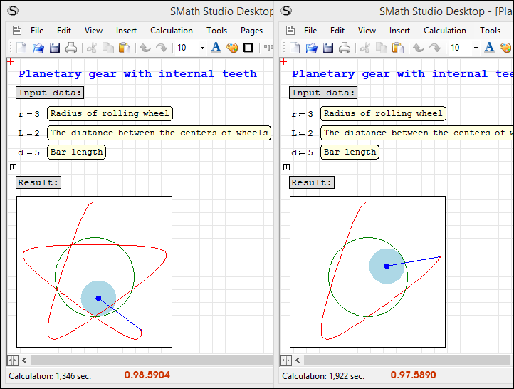

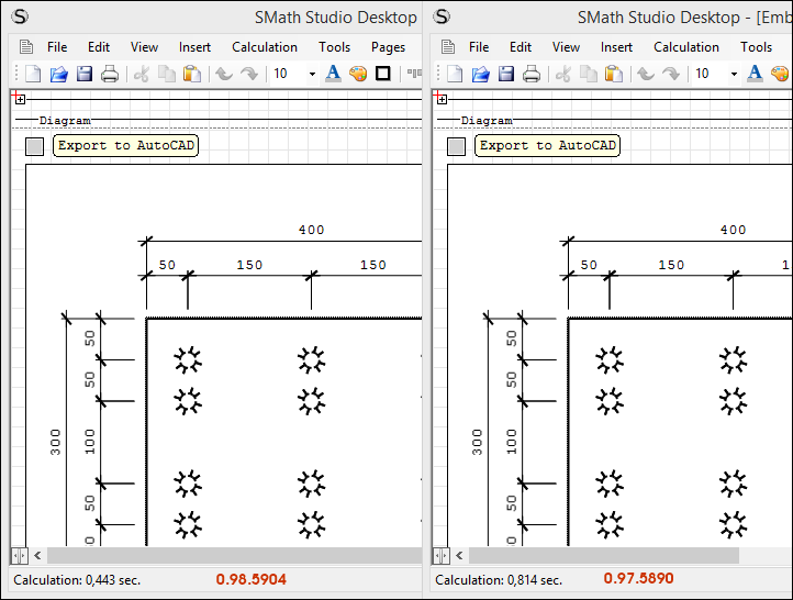

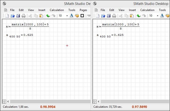

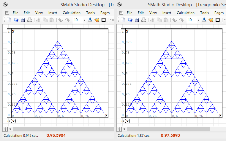

  • Calculation performance significantly improved (see timings in the following screenshots);

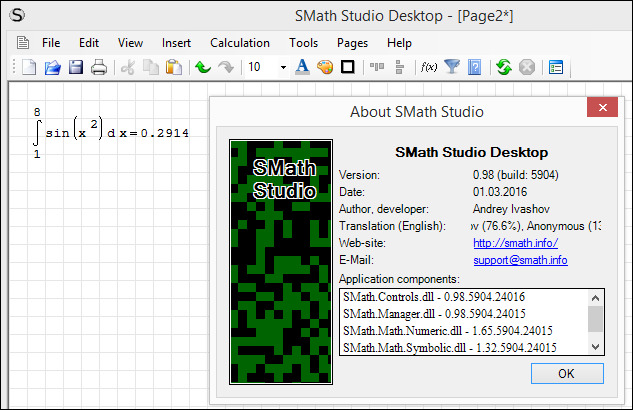

The following file worked well in Smath 97.5890 up to yesterday.
But under the latest version, the calculation for definite integral gives an error.
Can somebody help me in this regard please?

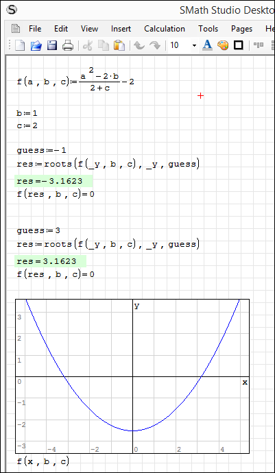

1. FindRoot function does not work.
2. Definite integral does not work.
It will not work for me as well, although I have to admit that I installed bunch of plugins.
However, fresh install with only Davide's Nonlinear Solvers (FindRoot() function is from there) and Martin's Smath Handbook will give this
1. FindRoot() will give the same error as on the picture
2. Definite integral works
Davide Carpi 3/2/2016 9:39:00 AM
#13 Posted: 3/2/2016 9:35:30 AM
1,443 likes in 2,936 posts.
NonlinearSolvers updated, try now
I have no problems with integrals, no exceptions in the files above (Reservoir Flood Capacity Estimation-R1 / TestSum).

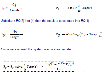

...Any information on the symbolics? I am trying to recreate a "proof" from a Mathcad file and I'm missing some features (or cannot find). Are we allowed to post Mathcad files on this forum? If so, I will post all of the relevant files.
Specifically, I thought that "symbolic solve of algebraic equations" was implemented in version .9X. Keywords in symbolics would be fantastic too!
From Mathcad
