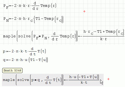

Maple Wrapper plugin can help with some symbolic problems.

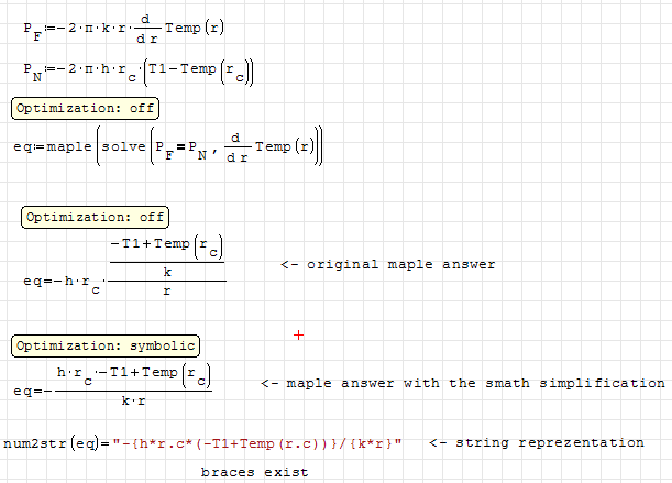

Hello Uni,
Which one is right, which is wrong ?
Personally: I would scrap Smath from subscripted variable.
#24 Posted: 2016/3/2 15:08:07
1,554 likes in 1,864 posts.
All answers are correct. I just have invisible braces. If you click on the expression, then they appear. I don't know why it happened.
#25 Posted: 2016/3/2 22:43:40
I trust you Uni, because I know you tell the truth.
But an an algebraic result to be copied as such, wrong.
Maple does not like subsrcipt. That by clicking it shows
the brackets, to me it is a bug that it does not
output the right result.
I accept the subscript as a local tutorial demo.
For real work and particularly for publishing: NO subscript.
Cheers, Jean

Why the 1rst display was wrong?
I don't know. May be Andrey will see this and make some comments.
