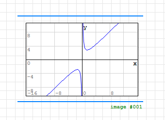

I like the concept, yet I'd prefer the lines and tags to be in a gray tone similar to the grid lines. The idea is that these elements aren't meant for the reader of a sheet, just for the author, who wishes to create some screenshots.

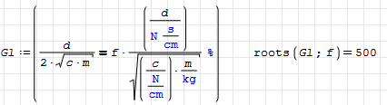

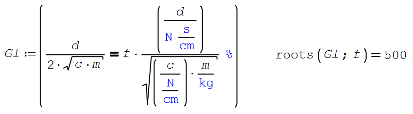

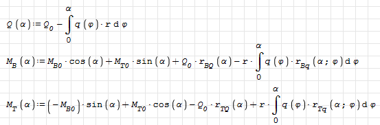

I observed that the clipboard copy of SMath region provides a high resolution bitmap. This seems to correspond to the screen resolution at zoom level 200%.
whereas the snapshot region provides the following:
Is that what I can expect from Snapshot region or should that be better and I am just doing something wrong?
Is there any chance to get something like the snapshot region (even without the option to clip regions) in the clipboard resolution? Any experience with playing around with system dpi settings, Windows scaling factor and the like?

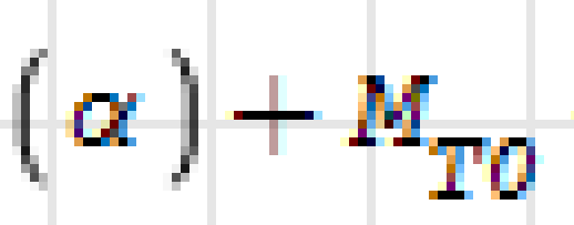

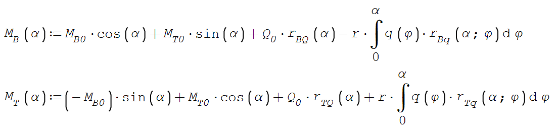

Here is another issue with the Snapshot resolution and/or with the default formula font and symbols. This has actually lead to wrong copy of a formula by a student.
In the following snapshot you have to look twice to distinguis + and -. The vertical bar in + is rendered gray and hard to see.
As long as the + glyph can't be adjusted, getting the snapshot in better resolution could mitigate the problem. Switching the font to times doesn't help, as the operator glyphs aren't affected by that.
I am also thinking of setting the font size to 20 and adjust all the worksheets and the screenshots in the book for better quality. I'd rather avoid that.
Possibly, this is not really a snapshot issue, because improved resolution would just help with the snapshots. In the UI at 100% zoom level, the problem would remain. So I'd suggest to increase the weight of the + operator.
This is taken from the shapshot in the book:
Only from font size 18 on, the vertical bar in + becomes black. This is what the student made from it.
The clipboard graphics resolution seems to be sufficient, yet it shows a rather thin weight of the operator bars.
