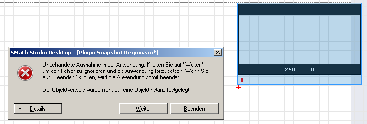

BTW: The region is not Ctrl-drag-proof.
WroteBTW: The region is not Ctrl-drag-proof.
What's the issue with ctrl+drag?
http://screencast-o-matic.com/watch/cIQTrhVm8V
mhhh... Isn't the same behavior of other regions?Wrotedone see the post above
Found & Fixed, thank youWroteSorry for being unspecific, see attachment. To relieve you have to press continue and then ESC to drop the copy operation.

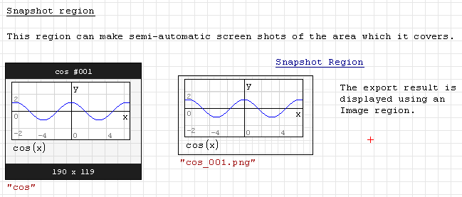

WroteHandbook page for Snapshot region added.
@kilele: your video shows, that you are writing a snapshot doc as well, is that right? If so, how about a bit of co-ordination? I really do not insist on documenting everything myself and would be happy to integrate contributions to the activebook (can be done via SVN). There is plenty of white spots, a lot of work yet to do...
Is my plugin reference's sheet, I'll send you a link
WroteI'd propose to write the export files with white background instead of translucent. Perhaps this might be an option. The problem shown in the attached image could also be solved by the image region providing white background. But that would not be entirely equivalent, because the Image region is currently unaware of the image dimensions.
That's an image region feature, the exported PNGs are not transparents (try yourself opening the images with an image editor)
