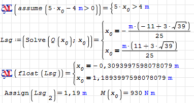

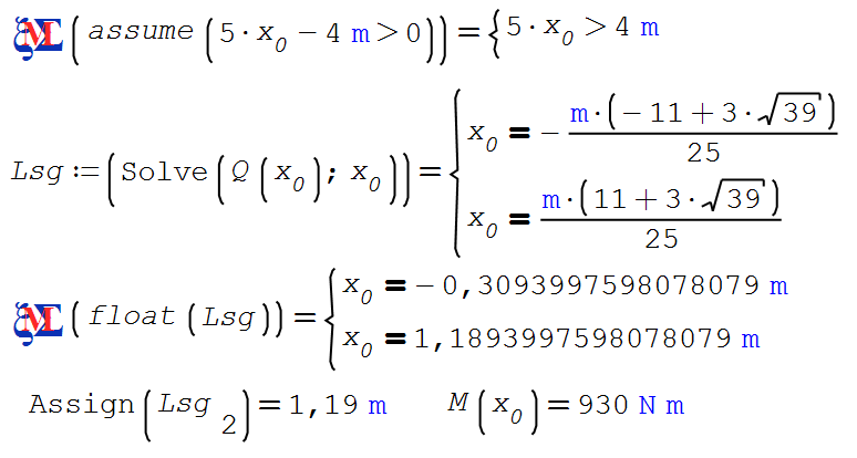

#56 Posted: 2023/11/29 08:06:54
1,355 likes in 2,271 posts.
I am using the snapshot region a lot for producing manuals on SMath Studio (see https://extmoodle.th-brandenburg.de/course/view.php?id=138§ion=2). The workflow allows for quick update and corrections.
Regions copied via clipboard to Word or other programs have much better image quality than the snapshots produced with the snapshot region. Here is an example:
Would it be possible to increase the resolution of the screenshots? The clipboard copies seem to have double the resolution compared to snapshots. I'd be happy to have that resolution also in the snapshots.
2-2-neu.sm (133.18 KiB) downloaded 1382 time(s).

#58 Posted: 2025/6/26 12:14:52
1,443 likes in 2,935 posts.
PLUGIN UPDATED
  • region style changed to make more obvious that you can interact with underlying regions.
  • compact mode image converted to SVG;
  • refactoring;
I think with the current API is possible, I'll give it a shot later.

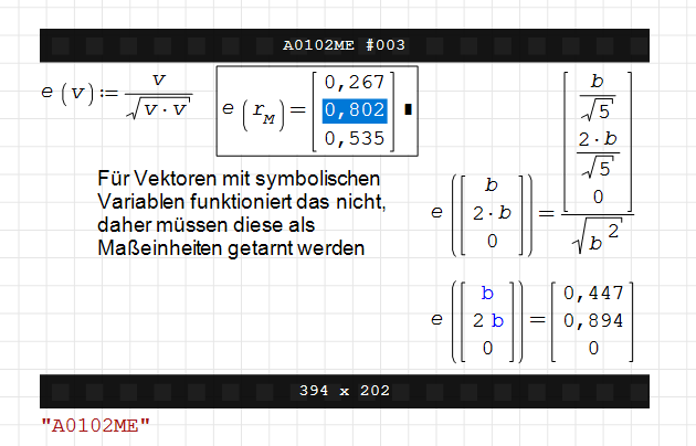

I'd like to rise again the proposal of some sort of "humble" style for snapshot regions, like in https://smath.com/en-US/forum/topic/SbW4Qx/Flexible-Export-to-image-formats#msg100816
I am currently preparing a book and want to share some of the examples in SMath in the cloud. For the book, the example files are full of snapshot regions. In the cloud version I don't like them because of their dominant formatting heavily impacts the appearance of the sheet. Therefore, I am finding myself continuously creating duplicates of the files where the snapshot regions are removed. That leads to increased workload when updating the examples.
Possible modifications would be:
- replace the two black bars by light grey thin lines (just like the region border)
- use the same light grey for the annotation (title, number and size).
Hiding the placeholder is possible from the context menu already.
The SMath roadmap promises to support third party plugins (as long as they run under Linux), thus it might be an option later to upload files with snapshot regions.
Edited 2025/6/27 09:17:07
Alvaro 2025/6/28 17:08:38

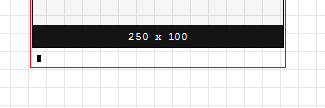

#60 Posted: 2025/7/2 14:21:12
I propose a middle ground.
A "snippet mode" layout while the region is focused, a less intrusive layout otherwise.
Proof of concept:
(not available in the gallery, download and drag&drop on the canvas) SnapshotRegion.1_1_9315_25145.zip (34.53 KiB) downloaded 277 time(s).
Edited 2025/7/3 11:05:27
