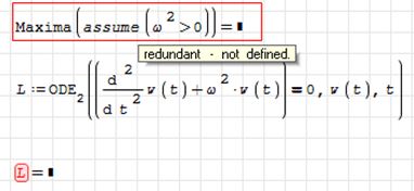

WroteI'am not able to use the assume function.
There are 17 ODEsolve in Smath that will do.
WroteHi,
Currently Maxima 5.42.2 is used.
I would appreciate any ideas
Thanks,
Lorenz

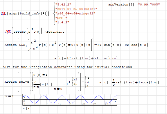

Can't reproduce.
You might want to use symbolic evaluation for the assume call.
![2019-04-05 00_23_41-SMath Studio 0.99.7005 - [ODE.2.sm_].png](/zh-Hans-CN/files/Download/sDxQzn/2019-04-05-00_23_41-SMath-Studio-0.99.7005---[ODE.2.sm_].png)
frapuano 2019/4/5 06:46:00
Also, can work with complexes ...

Hi Everybody,
thanks a lot.....I forgot to evaluate symbolically the assume command....
