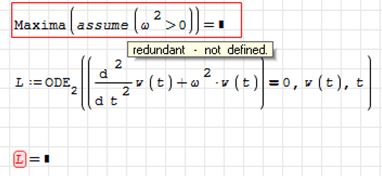

I'am not able to use the assume function.
Currently Maxima 5.42.2 is used.
I would appreciate any ideas
Thanks,
Lorenz

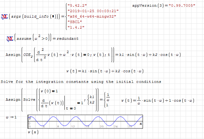

Can't reproduce.
You might want to use symbolic evaluation for the assume call.

Also, can work with complexes ...
MaxODE.2.sm (17,68 КиБ) скачан 1144 раз(а).

Hi Everybody,
thanks a lot.....I forgot to evaluate symbolically the assume command....
