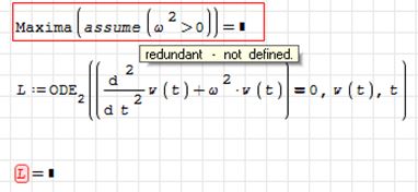

#1 Posted: 4/4/2019 11:11:28 AM
Lorenz Grimm
Lorenz Grimm
0 likes in 4 posts.
I'am not able to use the assume function.
Currently Maxima 5.42.2 is used.
I would appreciate any ideas
Thanks,
Lorenz

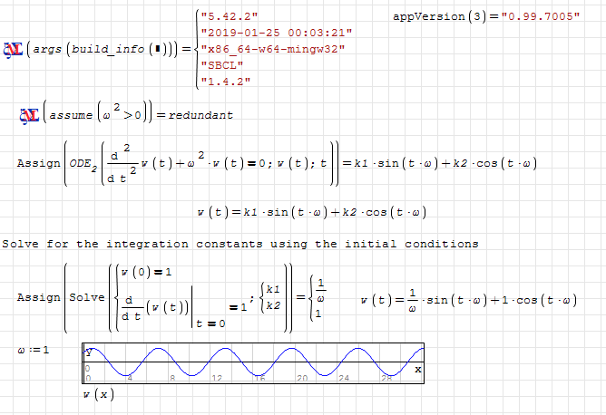

#3 Posted: 4/4/2019 7:26:12 PM
1,361 likes in 2,275 posts.
Thanks,
Lorenz
Can't reproduce.
You might want to use symbolic evaluation for the assume call.
frapuano 4/5/2019 6:46:00 AM

#5 Posted: 4/5/2019 4:15:27 AM
Lorenz Grimm
Lorenz Grimm
0 likes in 4 posts.
Hi Everybody,
thanks a lot.....I forgot to evaluate symbolically the assume command....
