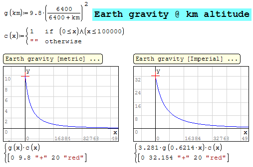

#7 Posted: 2019/7/16 18:04:20
It is by default in Imperial units and I would like it displayed in Metric Units.
Maybe that's just what you want ... in vice versa system

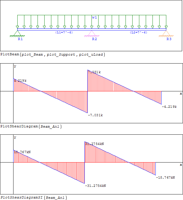

#14 Posted: 2019/7/19 07:27:42
1,443 likes in 2,935 posts.
Either
  1. Scale the input values
  2. Process FEA results using the plugin
  3. Fix the labels
or
  1. Process FEA results using the plugin
  2. Scale the output values
  3. Fix the labels
PlotShearDiagramSI.sm (5.03 KiB) downloaded 1138 time(s).

Looking at this in more detail, I am trying to get the deflection plot to be in SI units, I can get the in -> mm. The problem is the distance to the point of deflection, I cant get it to go from ft-in to m. what do I need to add to make this work?
