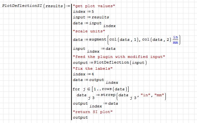

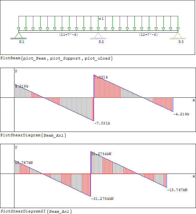

#14 Опубликовано: 19.07.2019 07:27:42
Either
  1. Scale the input values
  2. Process FEA results using the plugin
  3. Fix the labels
or
  1. Process FEA results using the plugin
  2. Scale the output values
  3. Fix the labels
PlotShearDiagramSI.sm (5,03 КиБ) скачан 1313 раз(а).
#15 Опубликовано: 10.08.2019 08:44:11
ianlh
ianlh
0 сообщений из 38 понравились пользователям.
Looking at this in more detail, I am trying to get the deflection plot to be in SI units, I can get the in -> mm. The problem is the distance to the point of deflection, I cant get it to go from ft-in to m. what do I need to add to make this work?
