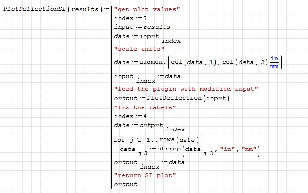

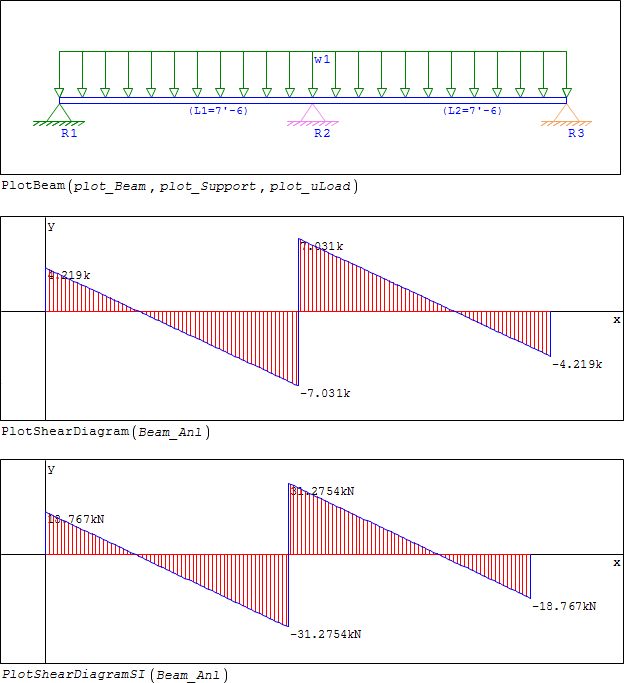

#14 Posted: 7/19/2019 7:27:42 AM
Either
or
PlotShearDiagramSI.sm (5.03 KiB) downloaded 1313 time(s).
![2019-07-19 12_23_05-SMath Studio - [Beam Analysis Sample-1.sm_].png](/en-US/files/Download/mCabpN/2019-07-19-12_23_05-SMath-Studio---[Beam-Analysis-Sample-1.sm_].png)
- Scale the input values
- Process FEA results using the plugin
- Fix the labels
or
- Scale the output values
- Fix the labels
