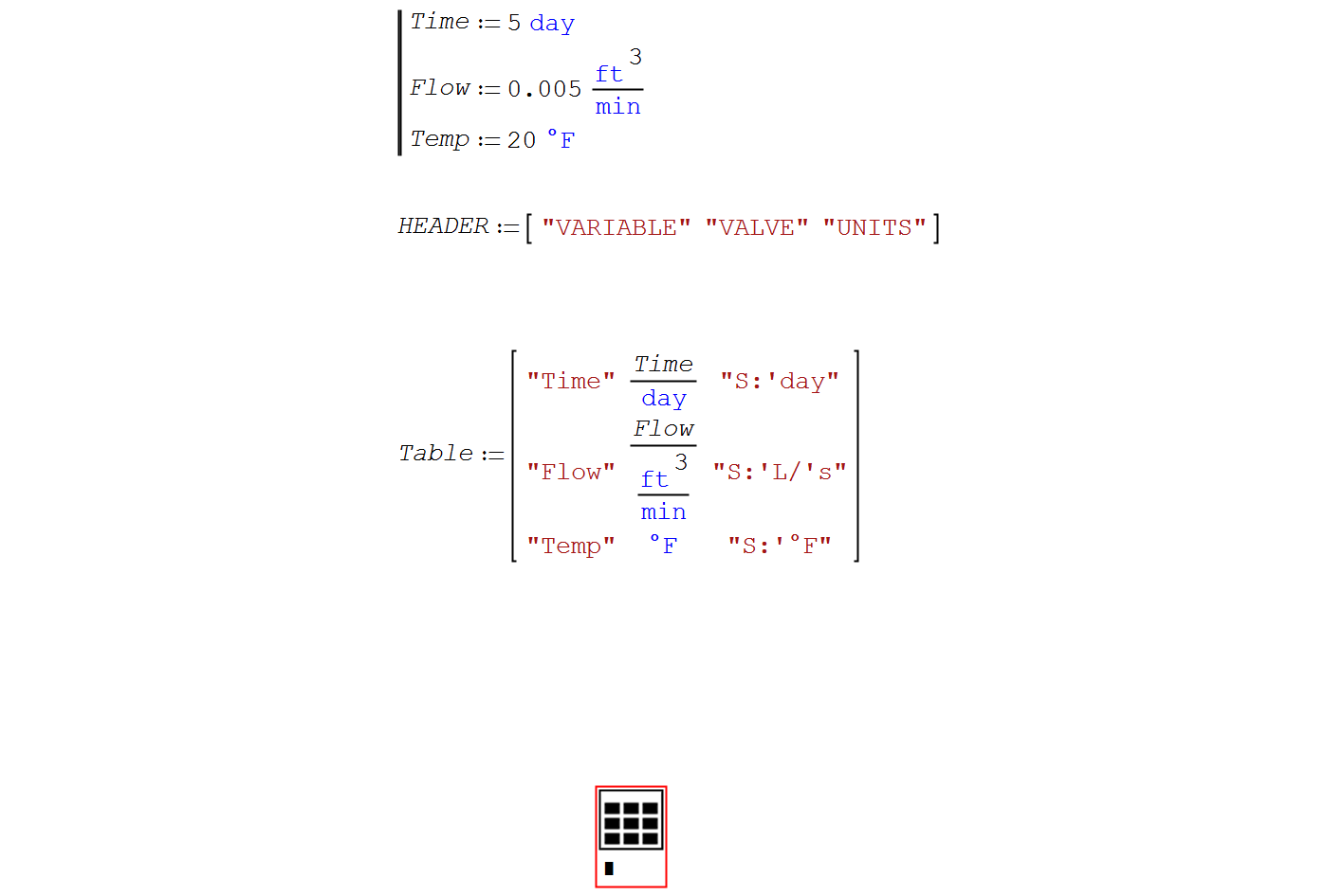

I just inserted a table region into my sheet, but I can't figure out how to change the number of rows or columns, or how to type in it. I select the boxes and a popup that I don't know what to do with pops up.

I typed exactly what is in the Table Region Carlos.sm and then added the table below with the Insert Table command, and still it does not work.

Once you have inserted the Table from the insert menu,
in that 3 x 3 chess board: type Table in the place holder.

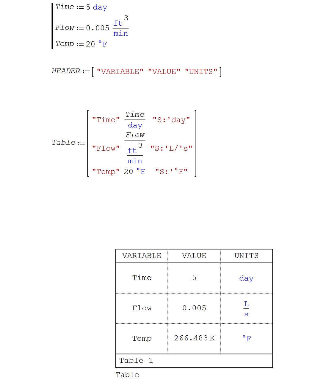

I defined the temp in degrees F, but it put it in degrees K

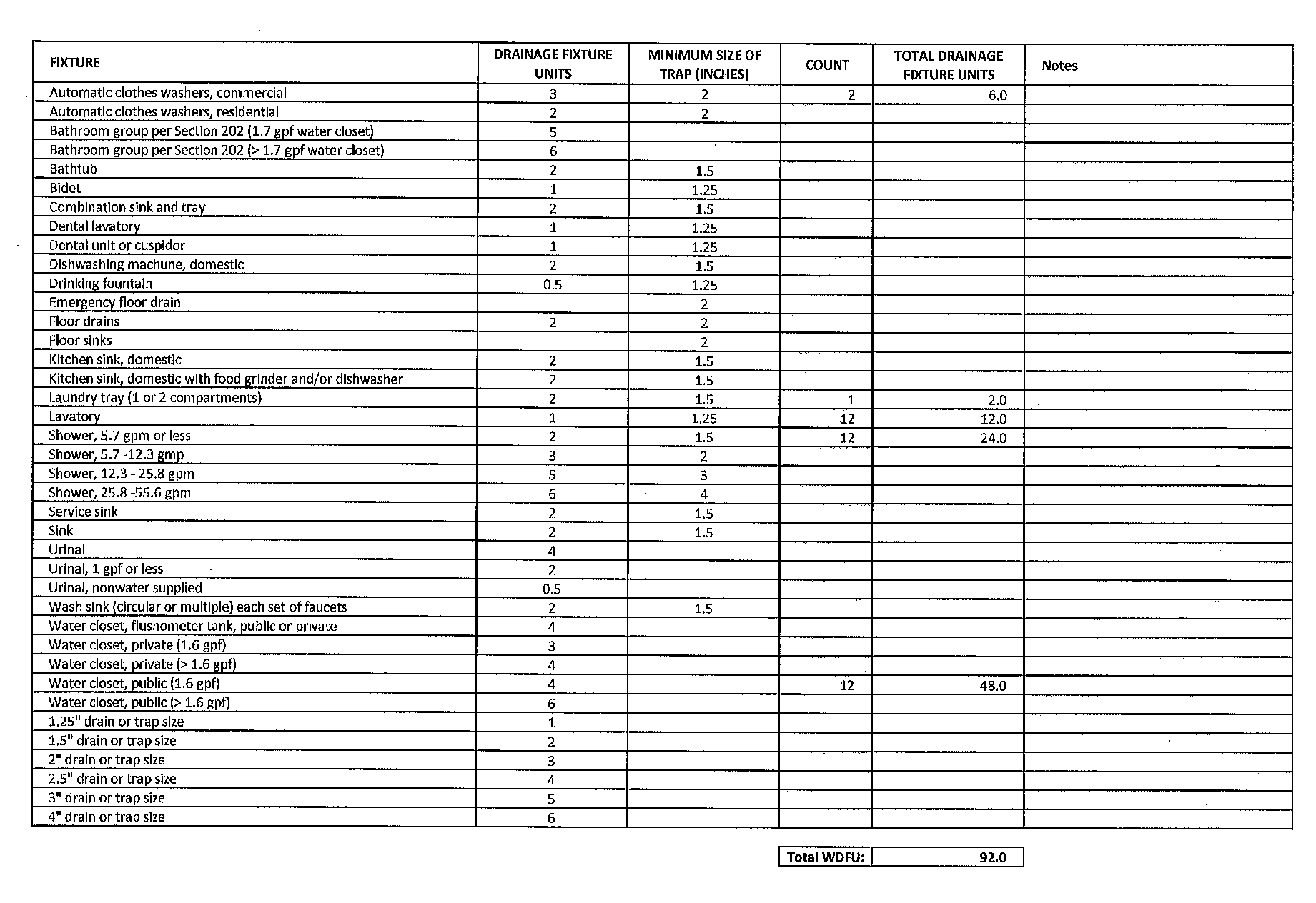

What I want to do is produce a table similar to the image I attached: DFU TABLE.png Also, What does the first definition do for the table? In the example it says
Time:= 5 day
Flow := 0.005 ft3/min
Temp := 20F
Smath is an advanced CAS. Maybe purchase a tool to list the barn population.
What about Excel, Word ... ?

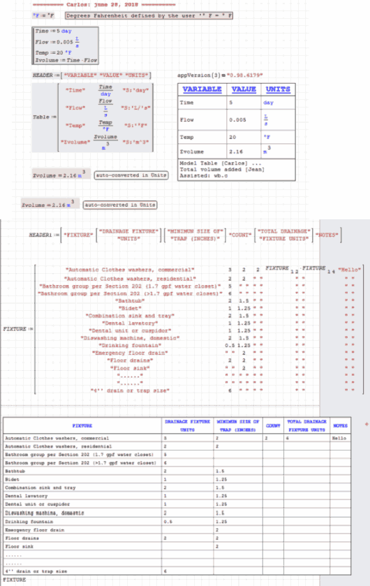

#8 Posted: 2019/4/24 16:57:57
CBG
CBG
78 likes in 312 posts.
Hello
This is a part of your table
Table Region Carlos_R1.sm (28.69 KiB) downloaded 1060 time(s).
Carlos

#12 Posted: 2019/5/10 19:05:03
CBG
CBG
After you produce the table in SMath, are the numbers in the table usable in a calculation? If not, then there is no point, and it is better to just copy and paste from Excel.
Of course, look at the operation fixture 1.2 by fixture 1.4, which results in 4. within the same table.
Carlos

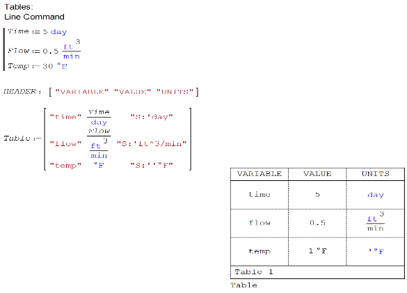

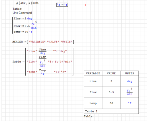

#18 Posted: 2019/5/14 16:52:24
CBG
CBG
test.sm (18.91 KiB) downloaded 1020 time(s).
Why does my table say 1 deg F and not 30 ?
Please: attach the document so helpers won't have to redo.
Here is the correction. It was still necessary to define your own unit of
degrees farenheit to prevent Smath Studio from interpreting it as Kelvin degrees.
On the other hand in the table was missing include the variable Temperature
(temp) divided by the units (° F)
test _Britt1.sm (19.93 KiB) downloaded 1060 time(s).

#19 Posted: 2019/5/14 16:57:31
1,443 likes in 2,935 posts.
I'd like it was completely arbitrary, I would have created some sort of artificial intelligence
Jokes aside, it is probably the value in the base unit (Kelvin).
I'm sorry but I'm from mobile right now, I can't check it deeply nor provide some example, I hope some of our skilled users can help you more here.
