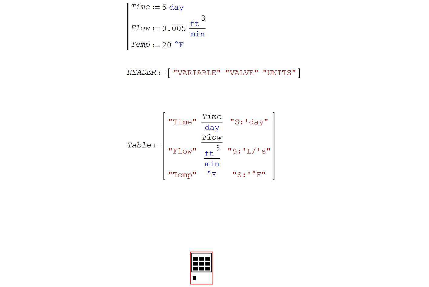

I just inserted a table region into my sheet, but I can't figure out how to change the number of rows or columns, or how to type in it. I select the boxes and a popup that I don't know what to do with pops up.

Once you have inserted the Table from the insert menu,
in that 3 x 3 chess board: type Table in the place holder.

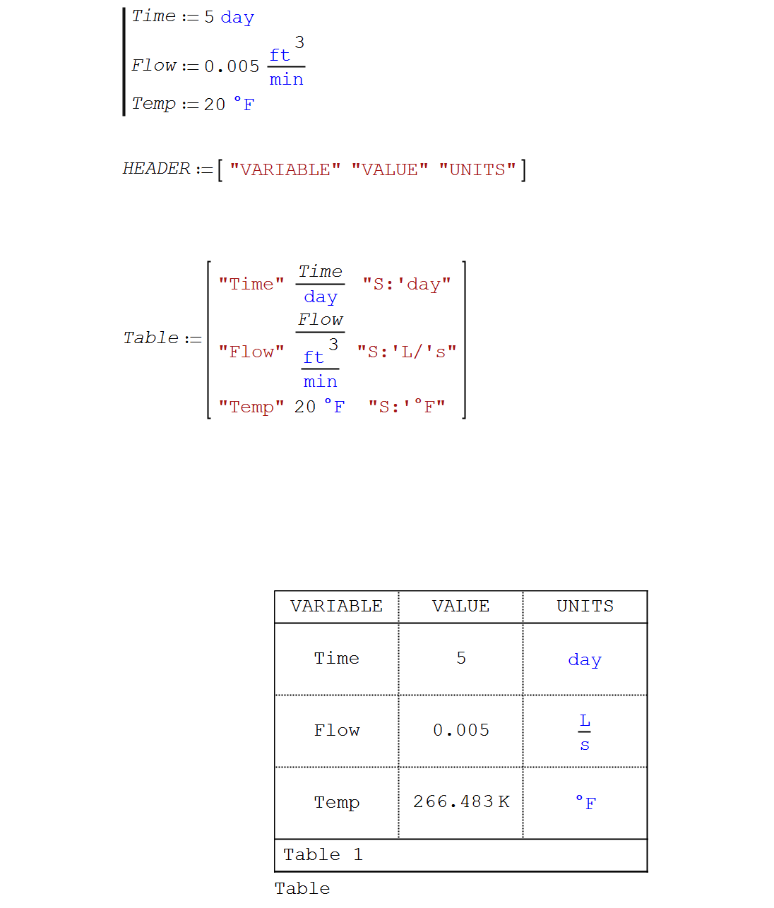

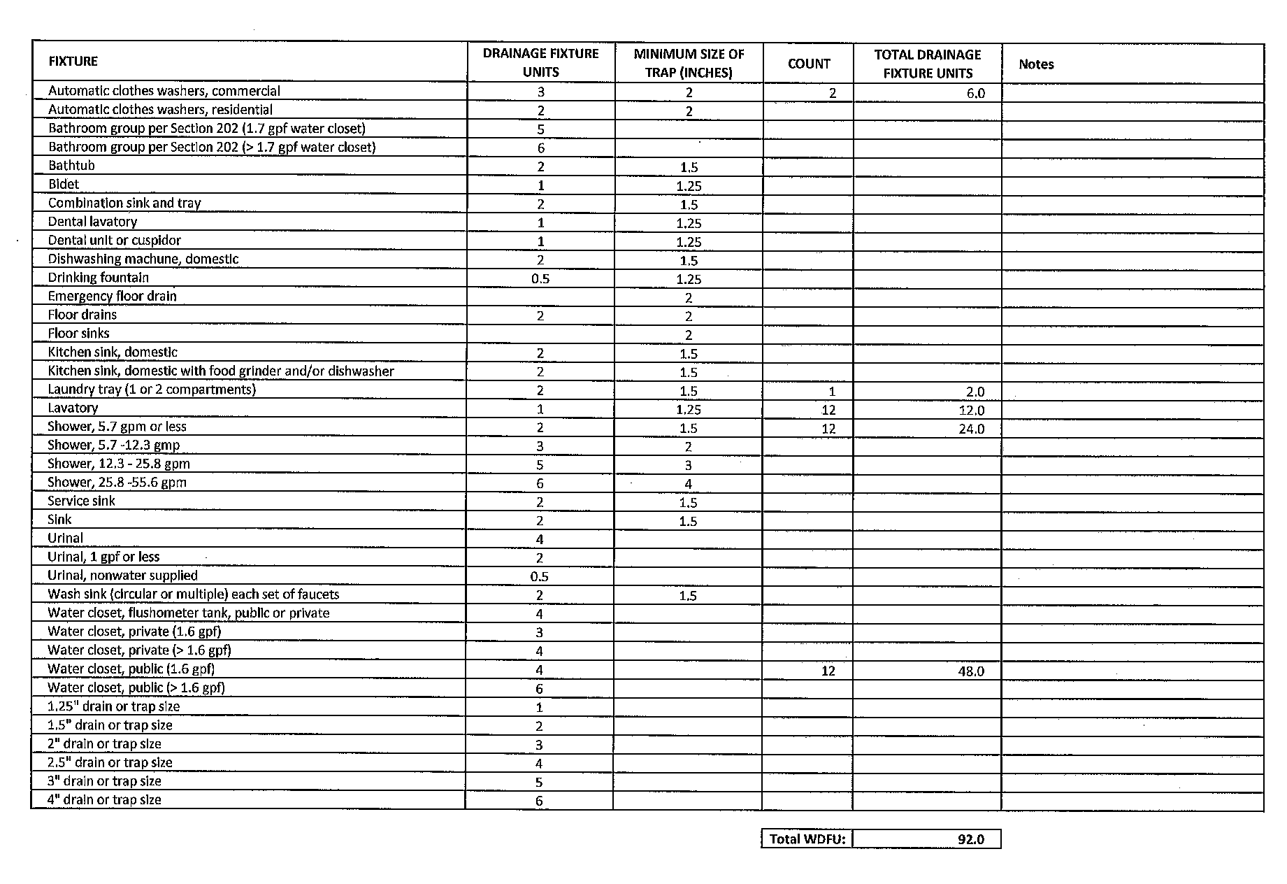

What I want to do is produce a table similar to the image I attached: DFU TABLE.png Also, What does the first definition do for the table? In the example it says
Time:= 5 day
Flow := 0.005 ft3/min
Temp := 20F

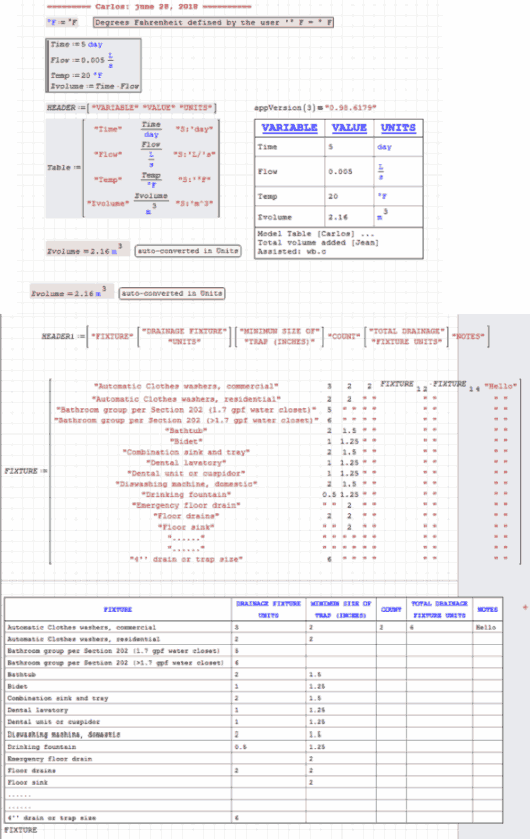

Hello
This is a part of your table
Table Region Carlos_R1.sm (28.69 KiB) downloaded 1220 time(s).
Carlos

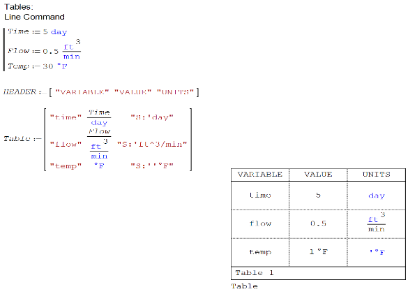

Seems to me that simply you are not using the Temp variable in your Table matrix.
then, it goes completely crazy and puts in an arbitrary value of 137.79

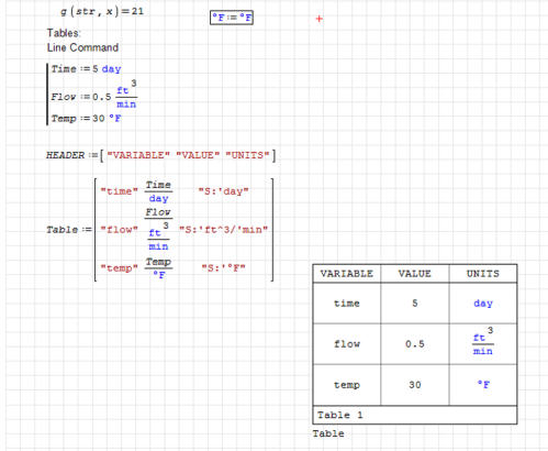

Here is the correction. It was still necessary to define your own unit of
degrees farenheit to prevent Smath Studio from interpreting it as Kelvin degrees.
On the other hand in the table was missing include the variable Temperature
(temp) divided by the units (° F)
test _Britt1.sm (19.93 KiB) downloaded 1224 time(s).
