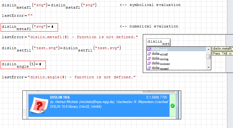

Thank you Viacheslav, disabling the recalculation I can save your example and I experienced some small improvements (still doesn't works):
Files (worksheet, log, output svg): DISLIN.zip (19.63 KiB) downloaded 482 time(s).
"Functions not defined":
![2016-02-14 18_44_49-SMath Studio Desktop - [Page2_].png](/zh-Hans-CN/files/Download/Dvao5P/2016-02-14-18_44_49-SMath-Studio-Desktop---[Page2_].png)
Aside note, crash occours if the output directory doesn't exists;

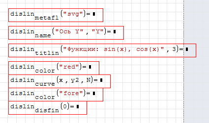

I forgot to say that you should not save the file! Look at the contents. Function names lost prefix. Therefore it is necessary to follow exactly what I write.
1. Restart SMath Studio.
2. Turn off autocalc.
3. Do not save the worksheet!
4. Enter functions line by line, don't forget to add = (do not press F9!).
5. Now you can press F9.
EDIT: The library interface is ugly. You must read the user manual before continuing experiments. The order of calling functions is important.
dislin.metafl("svg"
dislin.setfil("d:\\file.svg"
dislin.errdev("file"
dislin.errfil("d:\\out.txt"
dislin.filmod("delete"
dislin.disini(0)
dislin.disfin(0)

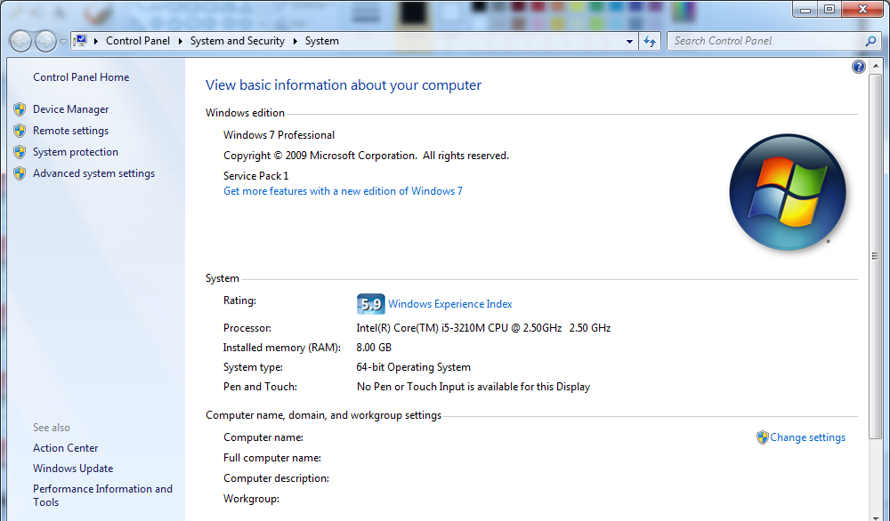

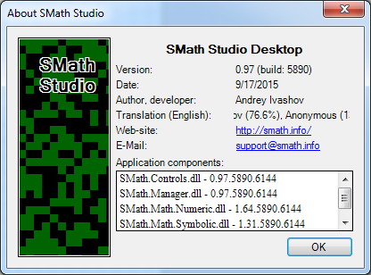

Strange on my system Smath crashes and I am forced to close the program.
The release installed is
Working under Windows 7 Professional
Franco
Franco

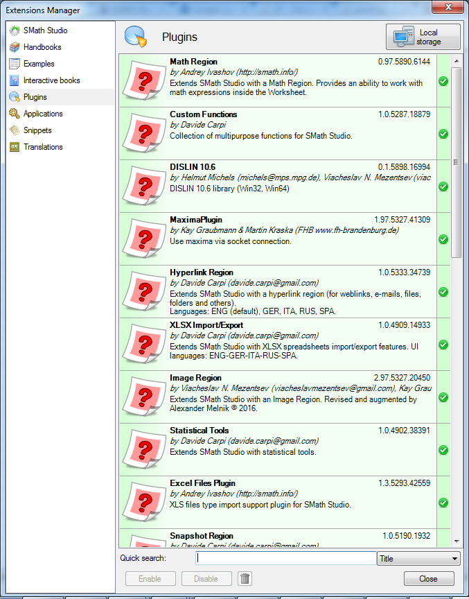

Uninstalled everything using Windows uninstall , then deleted Smath directory and other directories linked to Smath (I guess).
Reinstalled again downloading the last release from the site ...same result ( I haven't restarted the LT in between ) .
The example file loads and after a little bit comes up the screen with : Smath Studio Desktop has stopped working ..
Moreover I do not find any log.txt in the plugin folder and any dslin.something else anywhere on my computer ...make me wonder if the DSLIN plug in has been really downloaded and stored somewhere.
Franco
Franco
