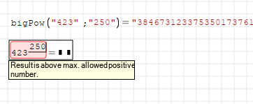

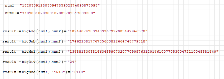

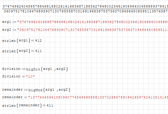

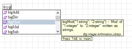

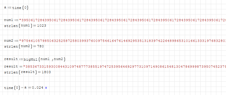

I have made a plugin to calculate big integers.
Actually I had coded it under SMath but it is way slow with very big numbers.
So I have made it a plugin which is coded with c#.
It gets the decimal as string, gives the result as string.
Do you think this would be useful for some instances?
biginteger_compiled.7z (4.4 KiB) downloaded 849 time(s).
source_code.7z (6 KiB) downloaded 885 time(s).
System.Numerics.7z (43.65 KiB) downloaded 853 time(s).

Well Jean, you are free not to use it if I publish it.
Here is the answer of you question.

Would that help solving the error "above max allowed ..." ???
Can you demonstrate an Engineering example not solvable otherwise ?
Big integers are used generally in encryption,
mathematical calculations where high-value numbers are handled,
image processing programs, financial analysis applications, etc.
Where you need big number data handling you can use big integer.
And notice, this is Big Integer Library.
It will help "above max allowed" if only variables and answer are integers.
What you are asking is Big Fractions Library.
Maybe someday I will implement fractions too, if I can.
No promises here.

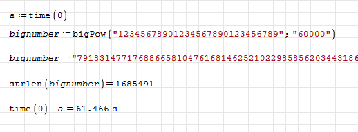

#12 Posted: 2021/1/8 15:11:15
598 likes in 1,380 posts.
Then you will like this library even more.
This functions can calculate and show
1.68 million digits in a minute.
12345678901234567890123456789^60000
Not so bad huh?

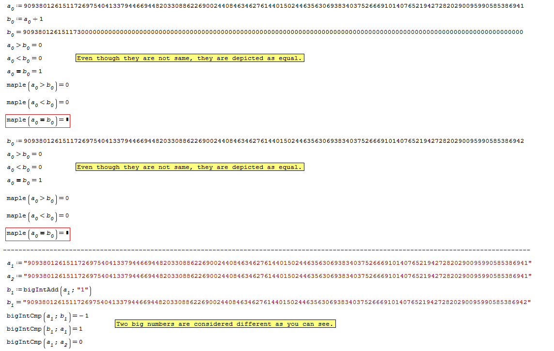

#15 Posted: 2021/1/9 14:44:51
I can't see any useful instance(s) for productive Smath projects.
Native Smath 6179 comes with Maple big Number expansion.
Maybe, I don't understand your proposal. Big Number does not self create.
Check the example below, the number has been directly copied from your example.
If you +1 that number, SMath (and maple plugin) can't tell the difference.
They are same to SMath (which in most cases won't matter) but not to big number calculation.
I understand, most of times it won't matter but what if it matters on special occasions?
It is clear you can't see its usefulness.
Maple support is crippled by SMath conversion, Davide or Martin mentioned about this.
And it is clear you don't understand my proposal.
Especially when everyone says "good idea" you insist on opposite.
Or you perseveringly try to divert the subject out of context.
Or you tenaciously try to advert your worksheets, which are irrelevant with subject.
This behavior is not helpful, you are just being rude.
You are doing this mostly on my posts by the way.
If you have any grudge on me lets clear it out now.
