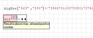

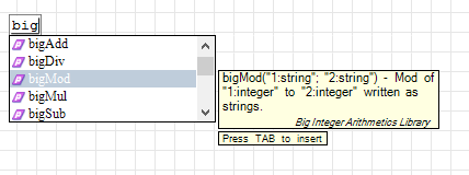

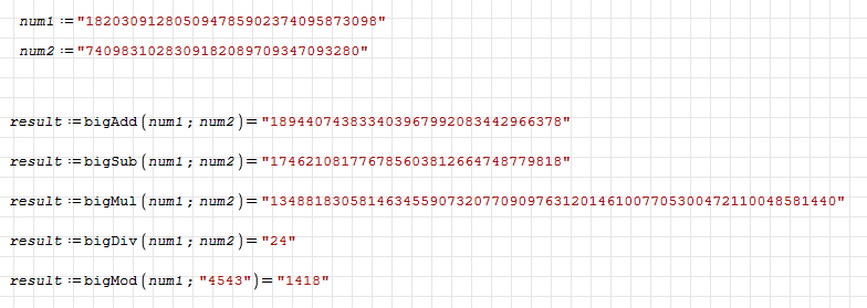

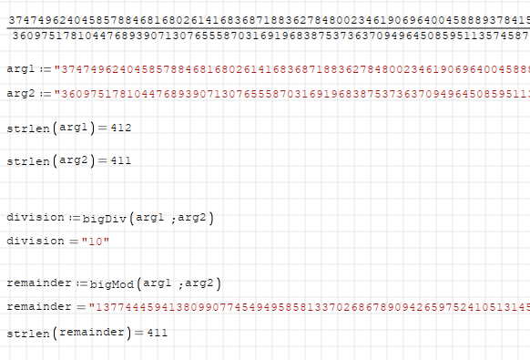

I have made a plugin to calculate big integers.
Actually I had coded it under SMath but it is way slow with very big numbers.
So I have made it a plugin which is coded with c#.
It gets the decimal as string, gives the result as string.
Do you think this would be useful for some instances?

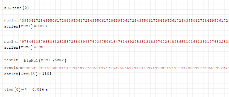

Then you will like this library even more.
This functions can calculate and show
1.68 million digits in a minute.
12345678901234567890123456789^60000
Not so bad huh?

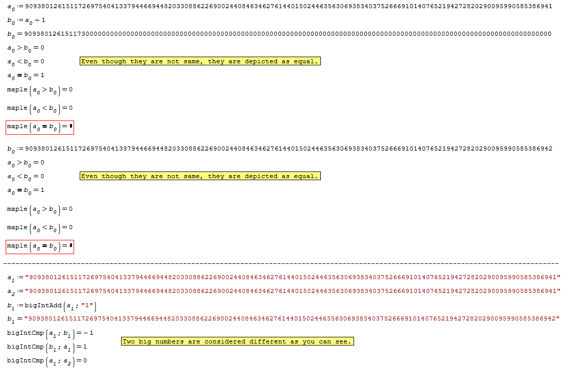

#15 Опубликовано: 09.01.2021 14:44:51
I can't see any useful instance(s) for productive Smath projects.
Native Smath 6179 comes with Maple big Number expansion.
Maybe, I don't understand your proposal. Big Number does not self create.
Check the example below, the number has been directly copied from your example.
If you +1 that number, SMath (and maple plugin) can't tell the difference.
They are same to SMath (which in most cases won't matter) but not to big number calculation.
I understand, most of times it won't matter but what if it matters on special occasions?
