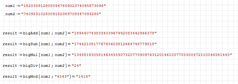

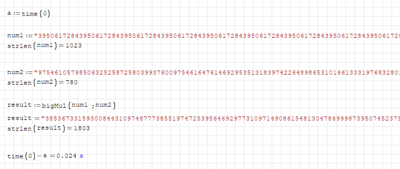

I have made a plugin to calculate big integers.
Actually I had coded it under SMath but it is way slow with very big numbers.
So I have made it a plugin which is coded with c#.
It gets the decimal as string, gives the result as string.
Do you think this would be useful for some instances?
biginteger_compiled.7z (4.4 KiB) downloaded 982 time(s).
source_code.7z (6 KiB) downloaded 1020 time(s).
System.Numerics.7z (43.65 KiB) downloaded 997 time(s).

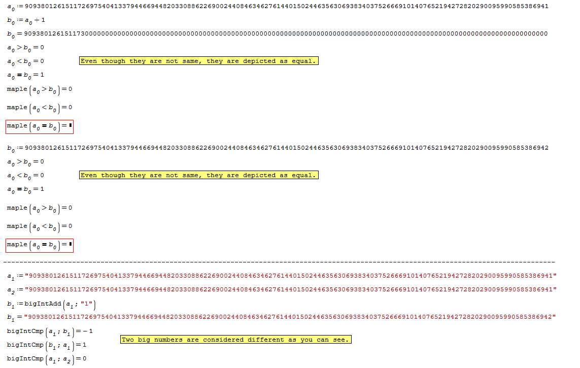

The big number code exists in Mathcad.

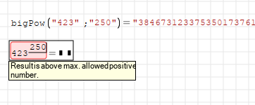

Would that help solving the error "above max allowed ..." ???
Can you demonstrate an Engineering example not solvable otherwise ?
Big integers are used generally in encryption,
mathematical calculations where high-value numbers are handled,
image processing programs, financial analysis applications, etc.
Where you need big number data handling you can use big integer.
And notice, this is Big Integer Library.
It will help "above max allowed" if only variables and answer are integers.
What you are asking is Big Fractions Library.
Maybe someday I will implement fractions too, if I can.
No promises here.
Alvaro 1/9/2021 4:47:00 AM
#11 Posted: 1/8/2021 10:50:31 AM

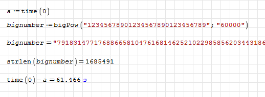

#12 Posted: 1/8/2021 3:11:15 PM
600 likes in 1,381 posts.
Then you will like this library even more.
This functions can calculate and show
1.68 million digits in a minute.
12345678901234567890123456789^60000
Not so bad huh?
