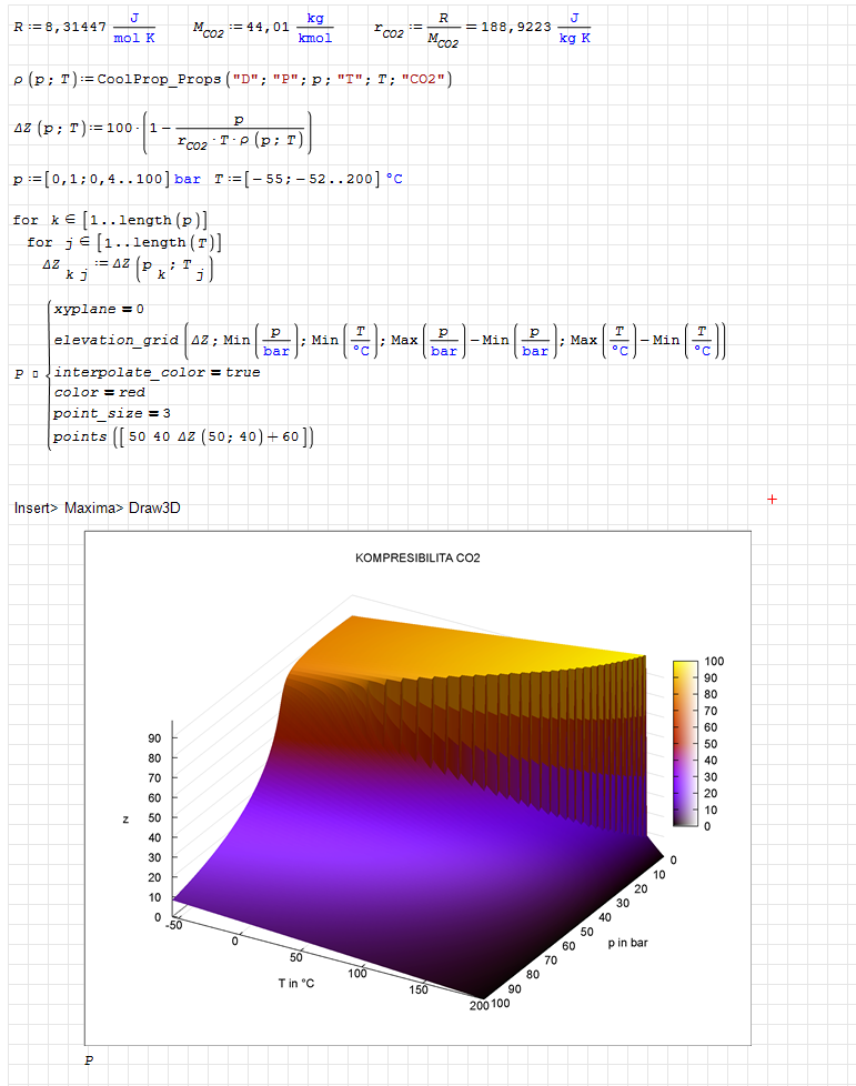

Hi, i would like to add some points to 3D plot. How can I do that?
And can i somehow make the plot smooth without using smaller steps in vectors?

You could try to create a mesh of triangles or quadrilateral objects. Then you are free to use a problem-adjusted surface parametrization.

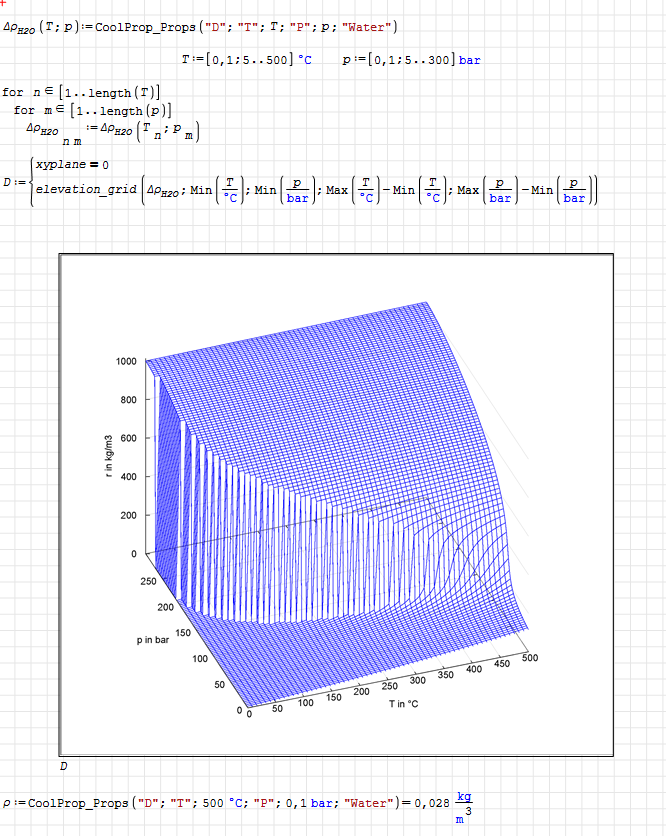

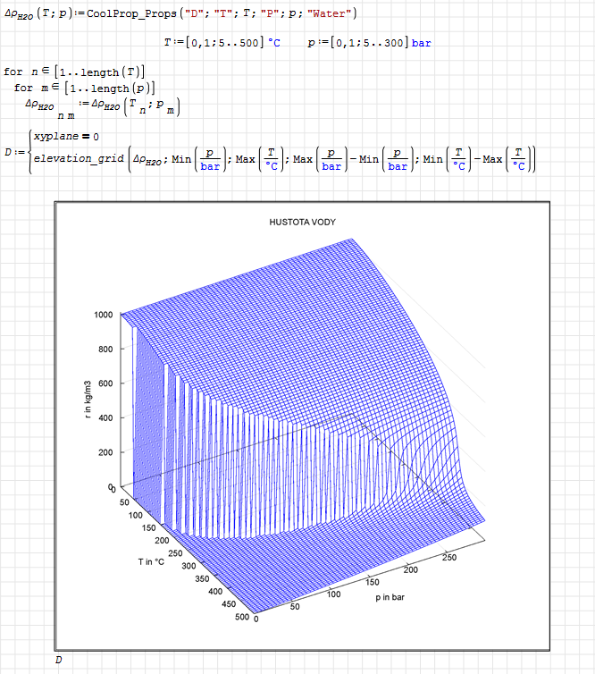

thanks for your answer. I have another question. I´m trying to make graph of water density, but the axes are not right, what is wrong?
hustota vody.sm (69 KiB) downloaded 526 time(s).

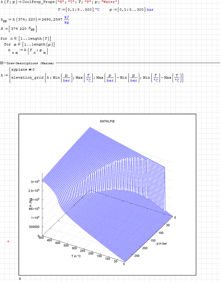

Thanks you very much! That helped.
But if i want to make axes right i have to switch x and y axes in elevation grid command. I don’t know why.
hustota vody.sm (135.01 KiB) downloaded 542 time(s).

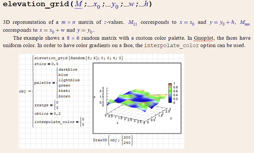

Is there any sheet of something like that, where I can fing all comands for plots? And how can I write them, because commands that I used, I copied from some file I found.

See topic starter https://smath.com/en-US/forum/topic/cnc5Xp/Maxima-Plugin. I added some references there.

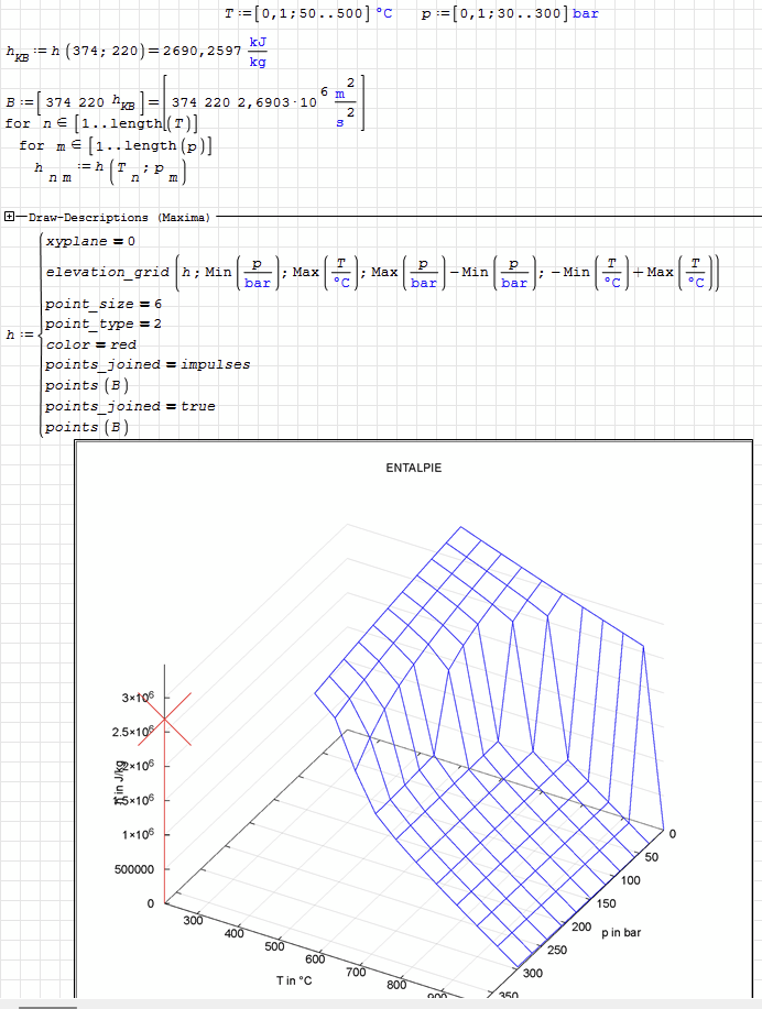

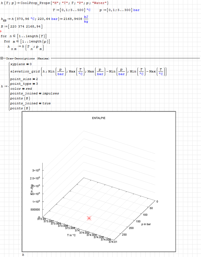

how can I add point B to plot? When I tried I make point or plot, but not both of them.
kriticky_bod.sm (202.22 KiB) downloaded 531 time(s).
Thanks for answers,
Tomas

Thanks for answer,
I tried to fix it and I ended with this. Still can t plot graph and point together.
kriticky_bod.sm (201.86 KiB) downloaded 496 time(s).
What should I do now?
Tomáš

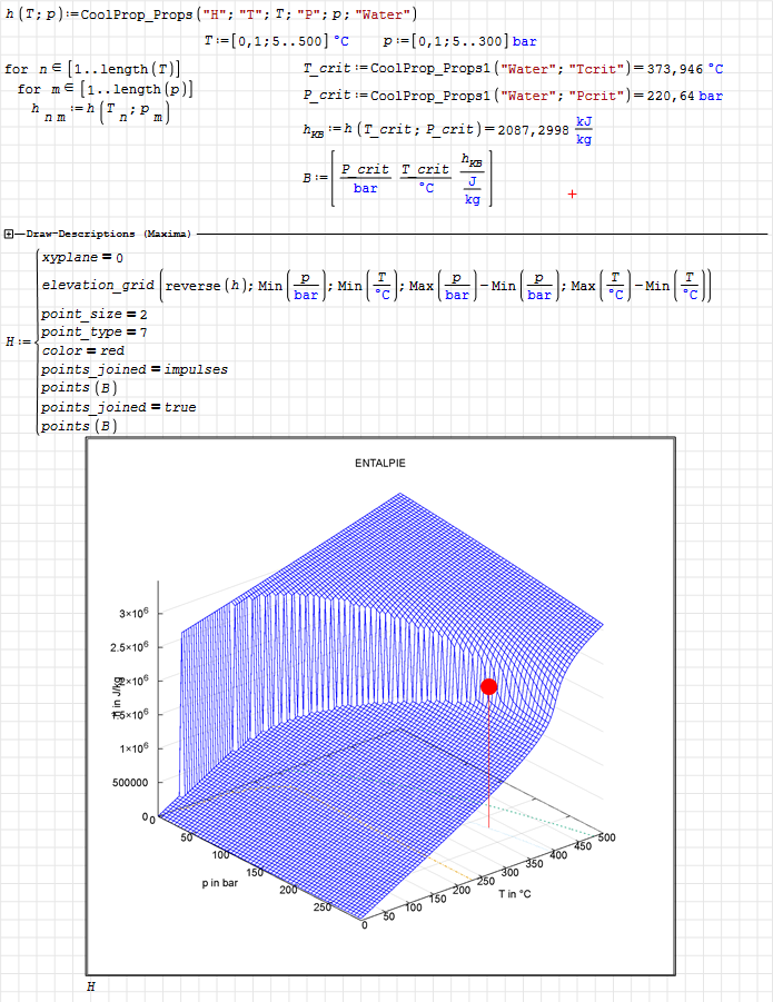

Tomáš
You still have a negative h value (temperature difference). Reverse this (and also reverse the matrix). Then it should work.
Good to see. You also might display the z values in MJ/kg to get nicer tick labels and play around with the view parameters in the settings menu to avoid interference between axis label and tick labels.

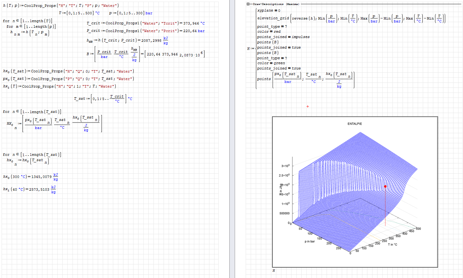

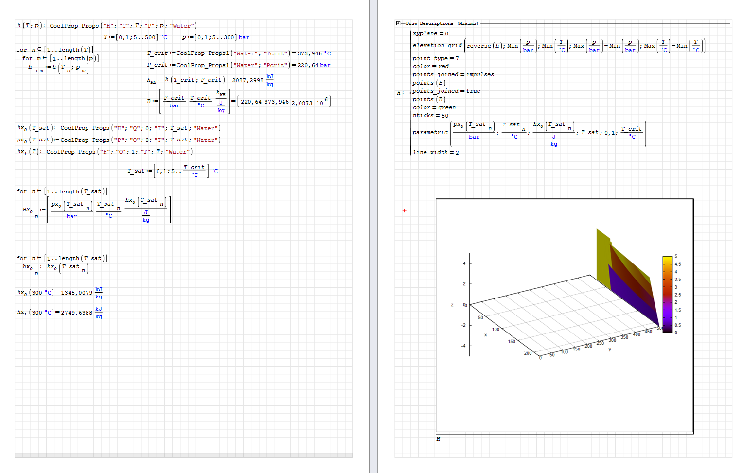

Now I would like to add saturation curve. Is it better to go with matrix or function? And how can I do that?
I tried parametric function, but plot did not work.
krit_bod_2.sm (211.84 KiB) downloaded 492 time(s).
Thanks for answers!
Tomáš

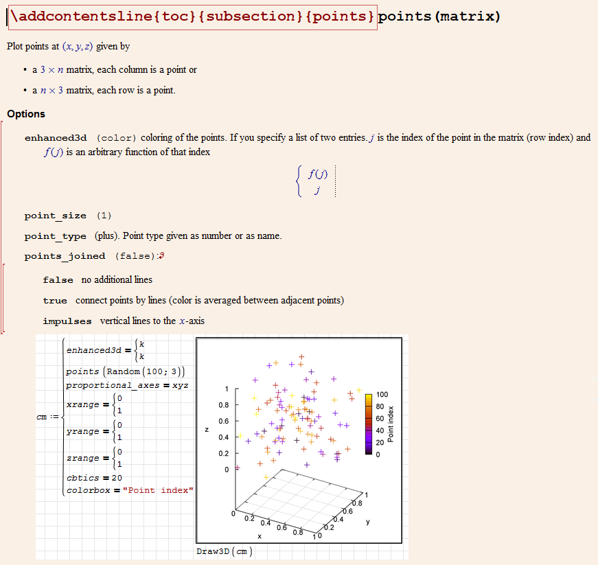

I guess it is best to use the points object just like for the single point. Set points_joined to true, point_type to something convenient. Using a function will work only if that function is supported by the interface to Maxima, which probably doesn't apply to coolprop functions or interpolated functions.

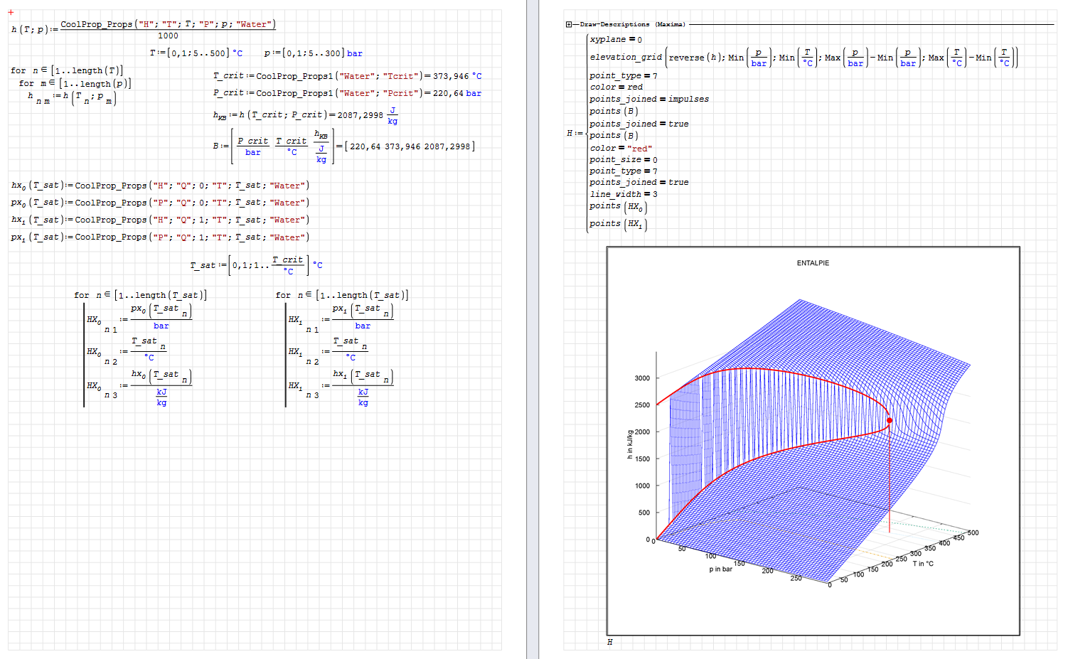

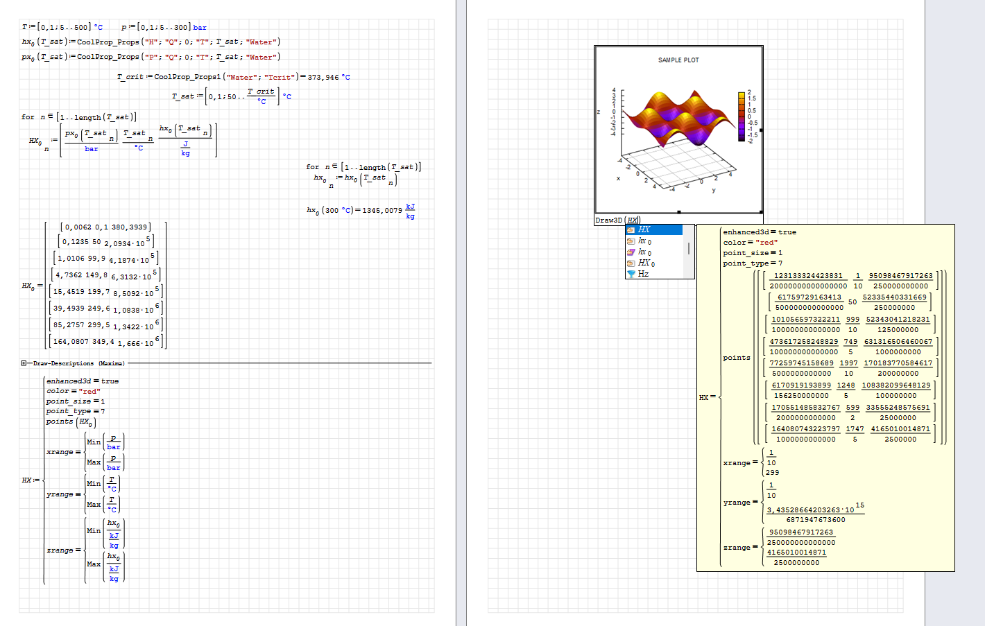

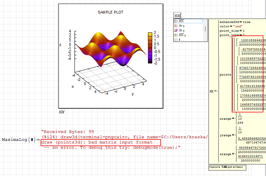

I’m back. I tried to create line of points by maxima handbook. Handbook is really great, but I couldn’t figure it out. What am I doing wrong? Matrix seems right.

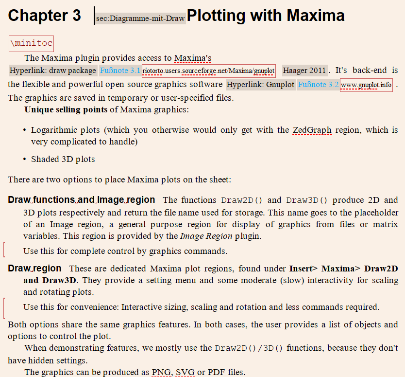

And i have another question. When I created plot of enthalpy I just wrote name of the "plot function". But in the manual, there is Draw3D("plot function"). Why is that?
saturation_curve.sm (194.75 KiB) downloaded 449 time(s).
Thanks for your help and patient, I really appriciate it.
Tomáš

Your data matrix isn't in the correct format. It is a one-column matrix of row vectors. Make it a real n x 3 matrix, then try again.
Also, you use different units when filling the data matrix (J/kg) and for the axis limits (kJ/kg).
As to the Draw3D command, see intro text to Chapter 3.
finally I’v done it! Thank you very much Martin! I think it looks great.
Now I would like to continue and mabye try to make something bigger and try to use Smath viewer.
