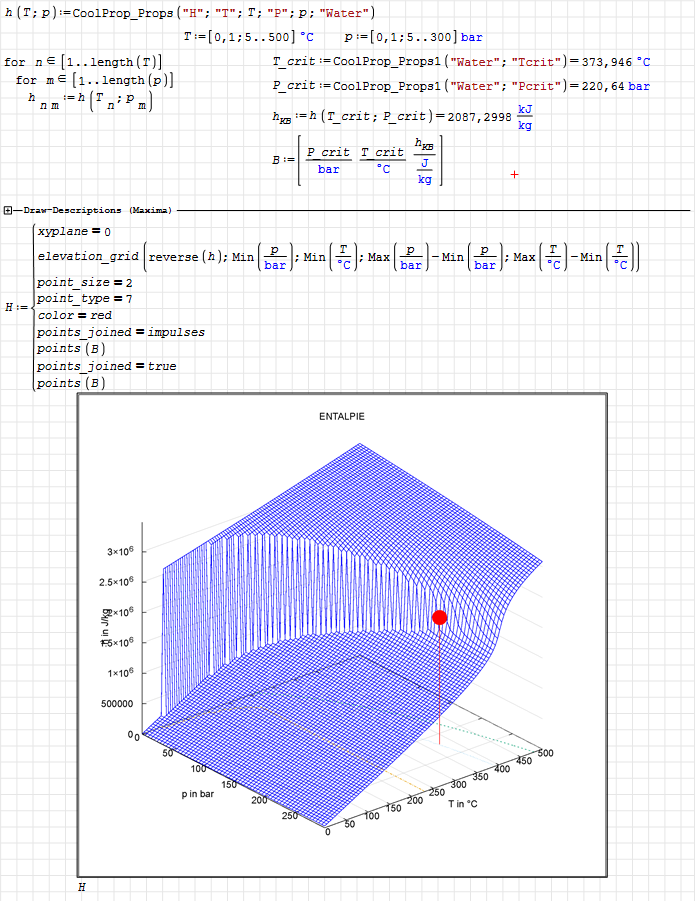

how can I add point B to plot? When I tried I make point or plot, but not both of them.

#9 Опубликовано: 06.02.2026 13:25:26
Seems to be related to the negative temperature range in the elevation_grid command.

I tried to fix it and I ended with this. Still can t plot graph and point together.

#11 Опубликовано: 10.02.2026 15:54:04
You still have a negative h value (temperature difference). Reverse this (and also reverse the matrix). Then it should work.

Thank you very much! It works.
Tomáš
#13 Опубликовано: 19.02.2026 10:12:49
Good to see. You also might display the z values in MJ/kg to get nicer tick labels and play around with the view parameters in the settings menu to avoid interference between axis label and tick labels.

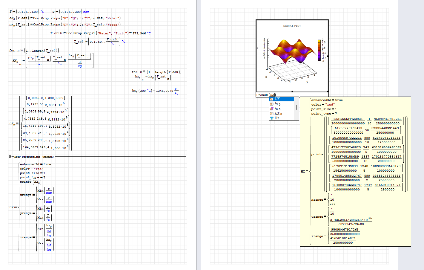

Now I would like to add saturation curve. Is it better to go with matrix or function? And how can I do that?
I tried parametric function, but plot did not work.

#15 Опубликовано: 19.02.2026 13:01:39

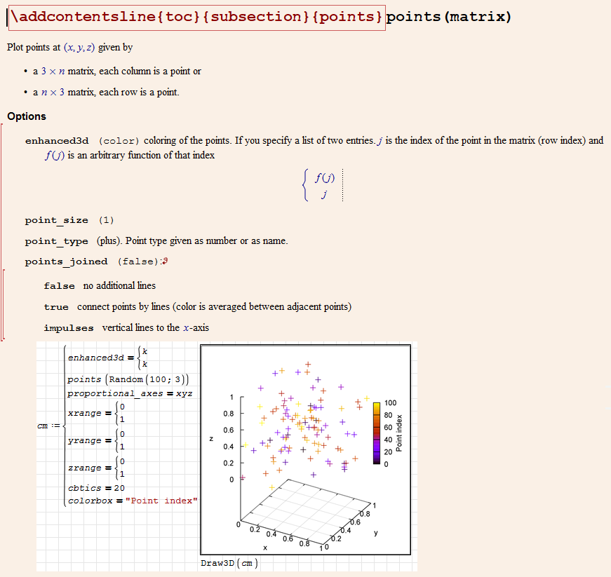

I guess it is best to use the points object just like for the single point. Set points_joined to true, point_type to something convenient. Using a function will work only if that function is supported by the interface to Maxima, which probably doesn't apply to coolprop functions or interpolated functions.

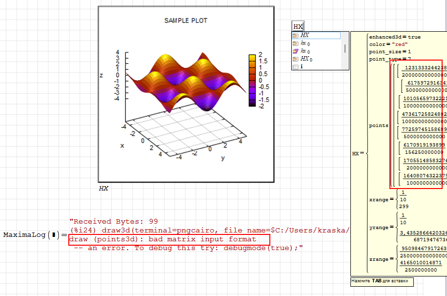

I’m back. I tried to create line of points by maxima handbook. Handbook is really great, but I couldn’t figure it out. What am I doing wrong? Matrix seems right.

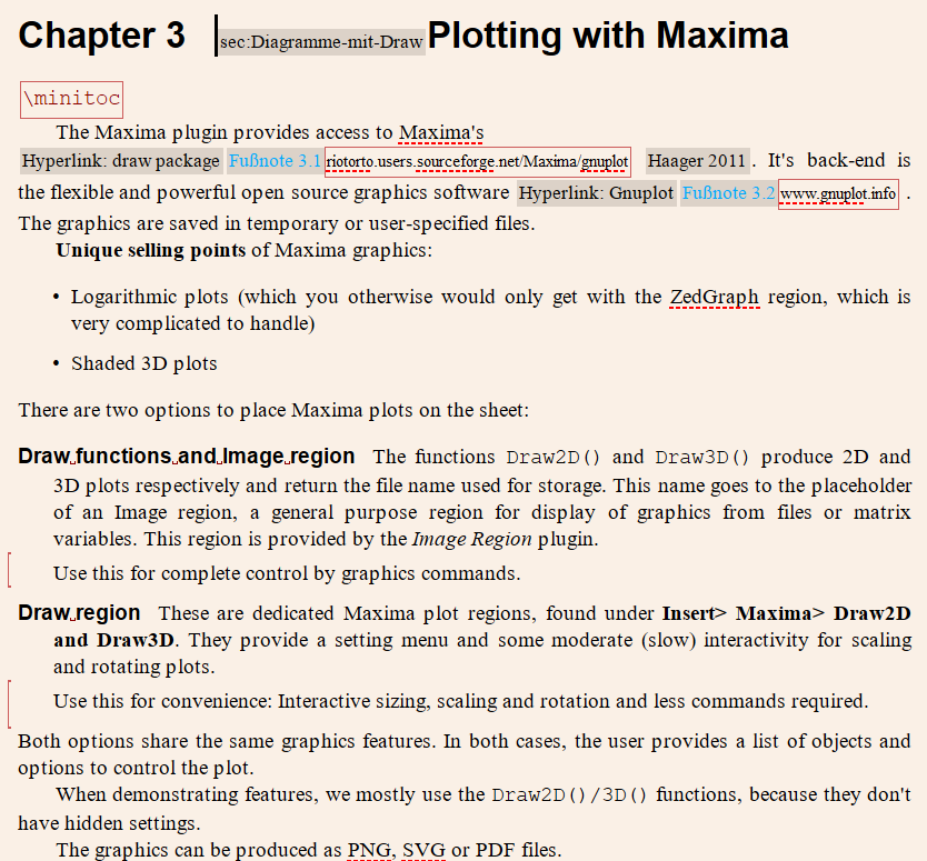

And i have another question. When I created plot of enthalpy I just wrote name of the "plot function". But in the manual, there is Draw3D("plot function"). Why is that?

#17 Опубликовано: 23.02.2026 10:20:19
Your data matrix isn't in the correct format. It is a one-column matrix of row vectors. Make it a real n x 3 matrix, then try again.
Also, you use different units when filling the data matrix (J/kg) and for the axis limits (kJ/kg).
As to the Draw3D command, see intro text to Chapter 3.

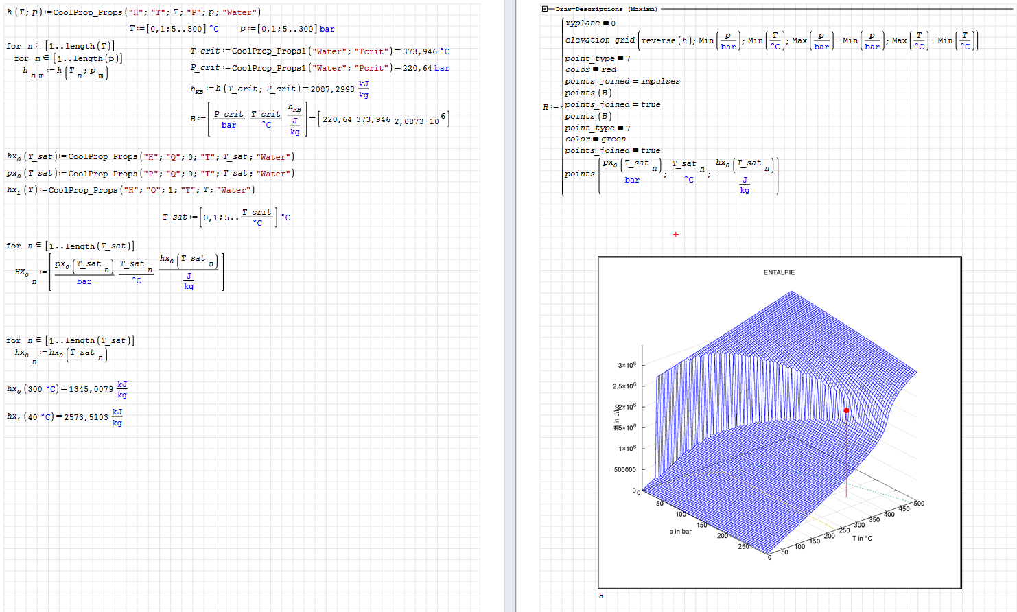

finally I’v done it! Thank you very much Martin! I think it looks great.
Now I would like to continue and mabye try to make something bigger and try to use Smath viewer.
Entalpie_pT.sm (156,56 КиБ) скачан 646 раз(а).
