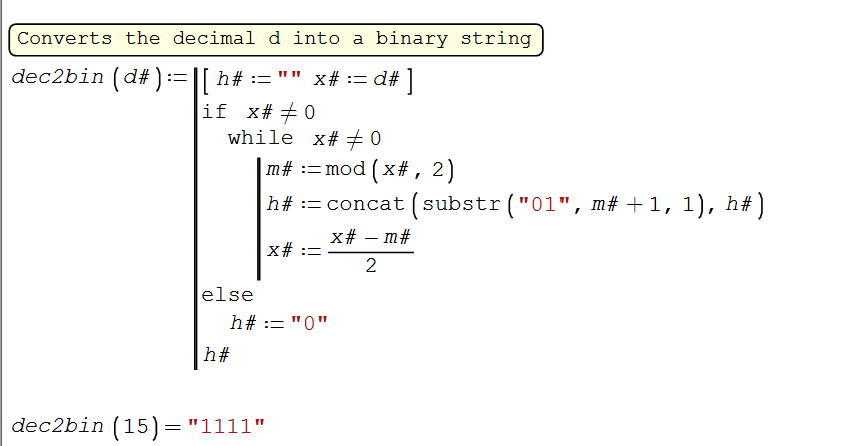

Epic dredge sorry. Functional, with all credit to @Razonar (source/author).
20221227 Dec2bin.sm (4.5 KiB) downloaded 1487 time(s).

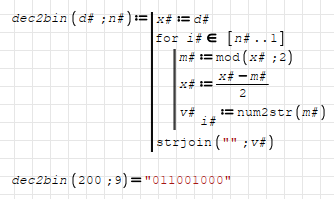

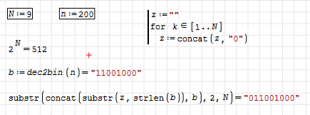

Modification of Razonar's dec2bin() should work well.
dec2bin(p,q) where p is the bit-field length and q is the decimal number to be converted.
Check the converted string's length and then pad the front with zeros to suit.

#15 Posted: 2022/12/29 20:46:04
598 likes in 1,380 posts.
Maybe this can be useful.
dec2bin.sm (3.8 KiB) downloaded 1407 time(s).
Mark R Harris 2022/12/29 21:03:00

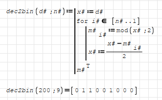

I spoke too soon! Bit-testing don't work so well on a string.
A much better idea is a column vector with each of the 9 (ie n#) elements being either a one or a zero.
#18 Posted: 2022/12/30 05:09:06
This was what I coded first, after that I made it to string.
Here is what you have asked for.
dec2bin.sm (6.09 KiB) downloaded 1389 time(s).
Mark R Harris 2022/12/30 06:38:00

#20 Posted: 2022/12/30 11:05:26
Maybe, that's what you are looking for ?
Maths Convert num2str EXTENDED.sm (6.72 KiB) downloaded 1454 time(s).
