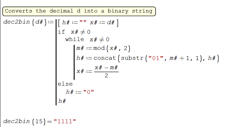

Epic dredge sorry. Functional, with all credit to @Razonar (source/author).
20221227 Dec2bin.sm (4,5 КиБ) скачан 1715 раз(а).

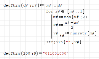

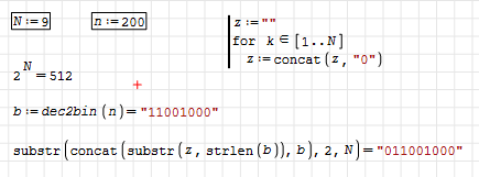

Modification of Razonar's dec2bin() should work well.
dec2bin(p,q) where p is the bit-field length and q is the decimal number to be converted.
Check the converted string's length and then pad the front with zeros to suit.

Maybe this can be useful.
dec2bin.sm (3,8 КиБ) скачан 1606 раз(а).

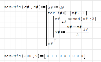

I spoke too soon! Bit-testing don't work so well on a string.
A much better idea is a column vector with each of the 9 (ie n#) elements being either a one or a zero.
#18 Опубликовано: 30.12.2022 05:09:06
This was what I coded first, after that I made it to string.
Here is what you have asked for.
dec2bin.sm (6,09 КиБ) скачан 1590 раз(а).
Mark R Harris 30.12.2022 06:38:00

Thank you so much overlord, that is both elegant and perfect!
