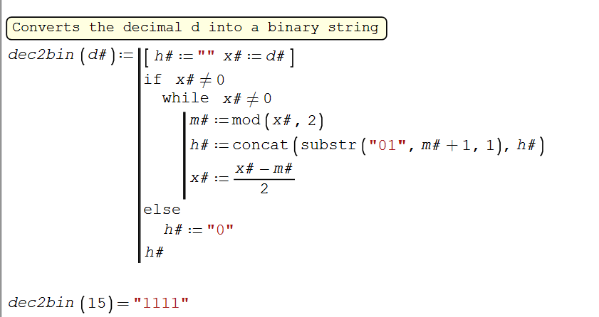

Epic dredge sorry. Functional, with all credit to @Razonar (source/author).
20221227 Dec2bin.sm (4.5 KiB) downloaded 1714 time(s).

Thanks, nice source code.
algo(col) was designed to recover matrix col(s) string(s) to values.
Cheers ... Jean.
Maths Convert-dec2bin.sm (18.88 KiB) downloaded 1607 time(s).

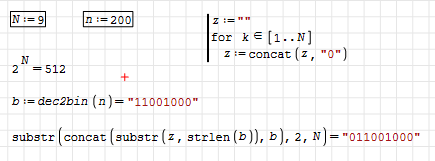

Modification of Razonar's dec2bin() should work well.
dec2bin(p,q) where p is the bit-field length and q is the decimal number to be converted.
Check the converted string's length and then pad the front with zeros to suit.

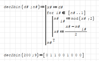

I spoke too soon! Bit-testing don't work so well on a string.
A much better idea is a column vector with each of the 9 (ie n#) elements being either a one or a zero.
#18 Posted: 12/30/2022 5:09:06 AM
600 likes in 1,381 posts.
This was what I coded first, after that I made it to string.
Here is what you have asked for.
dec2bin.sm (6.09 KiB) downloaded 1588 time(s).

Thank you so much overlord, that is both elegant and perfect!

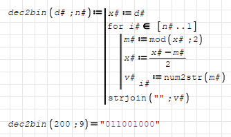

#20 Posted: 12/30/2022 11:05:26 AM
Maybe, that's what you are looking for ?
Maths Convert num2str EXTENDED.sm (6.72 KiB) downloaded 1651 time(s).
