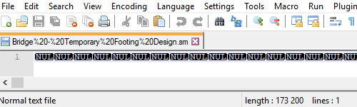

My notepad++ shows a long sequence of null control characters (unicode \u0000)... at least we have a date, this is an important clue... me too I remember at least another file like this (linked below)... keep reporting if it happens saving with most recent 0.98 versions...

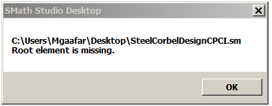

Hi, I was trying to open an Smath sheet but I always get this error message:
"Root element is missing"
the problem is all the copies that I have don't open and give me the same error.
Does anyone know how to fix this error?

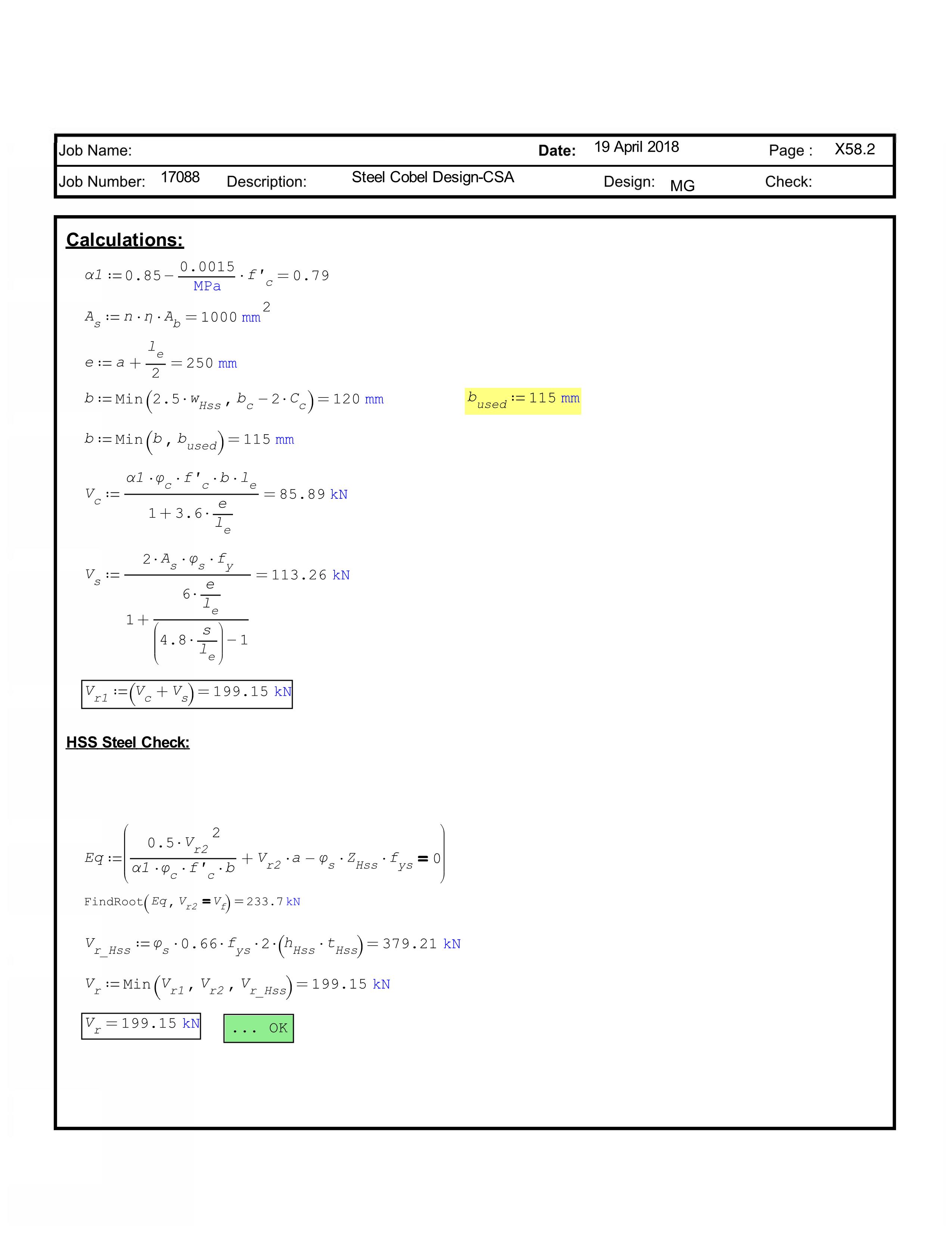

I am also attaching a snap shot of the sheet that I had it printed before for reference.
Thanks

Sorry for the big snap shot, did not realise that it is that big.
I also checked the size of file and it is 384 kb and not 0
attached file for reference.

I opened your file on Notepad++ and I found that is full of NULL characters. Same you can see in any other text editos (atom, and so on)...
Sorry...
