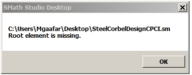

Hi, I was trying to open an Smath sheet but I always get this error message:
"Root element is missing"
the problem is all the copies that I have don't open and give me the same error.
Does anyone know how to fix this error?

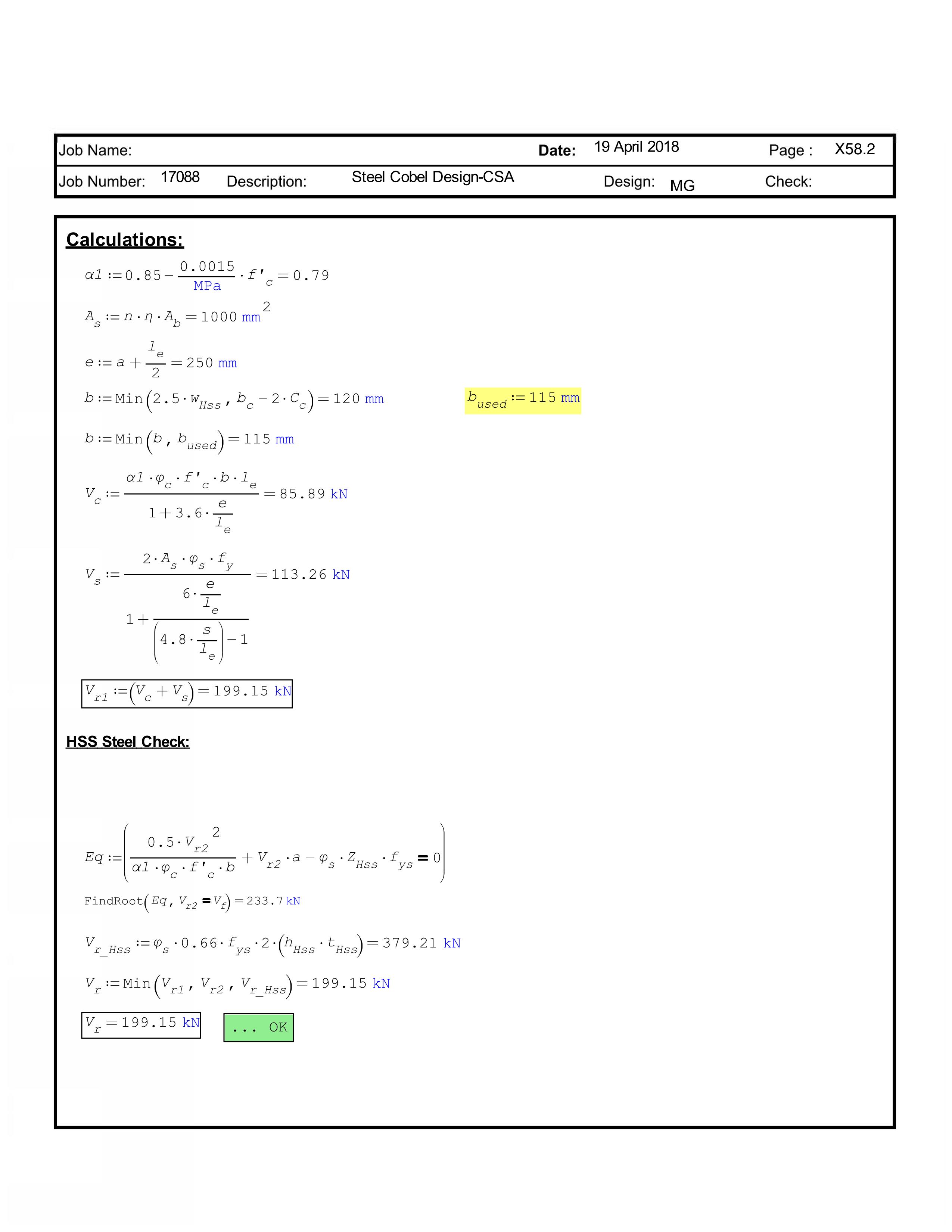

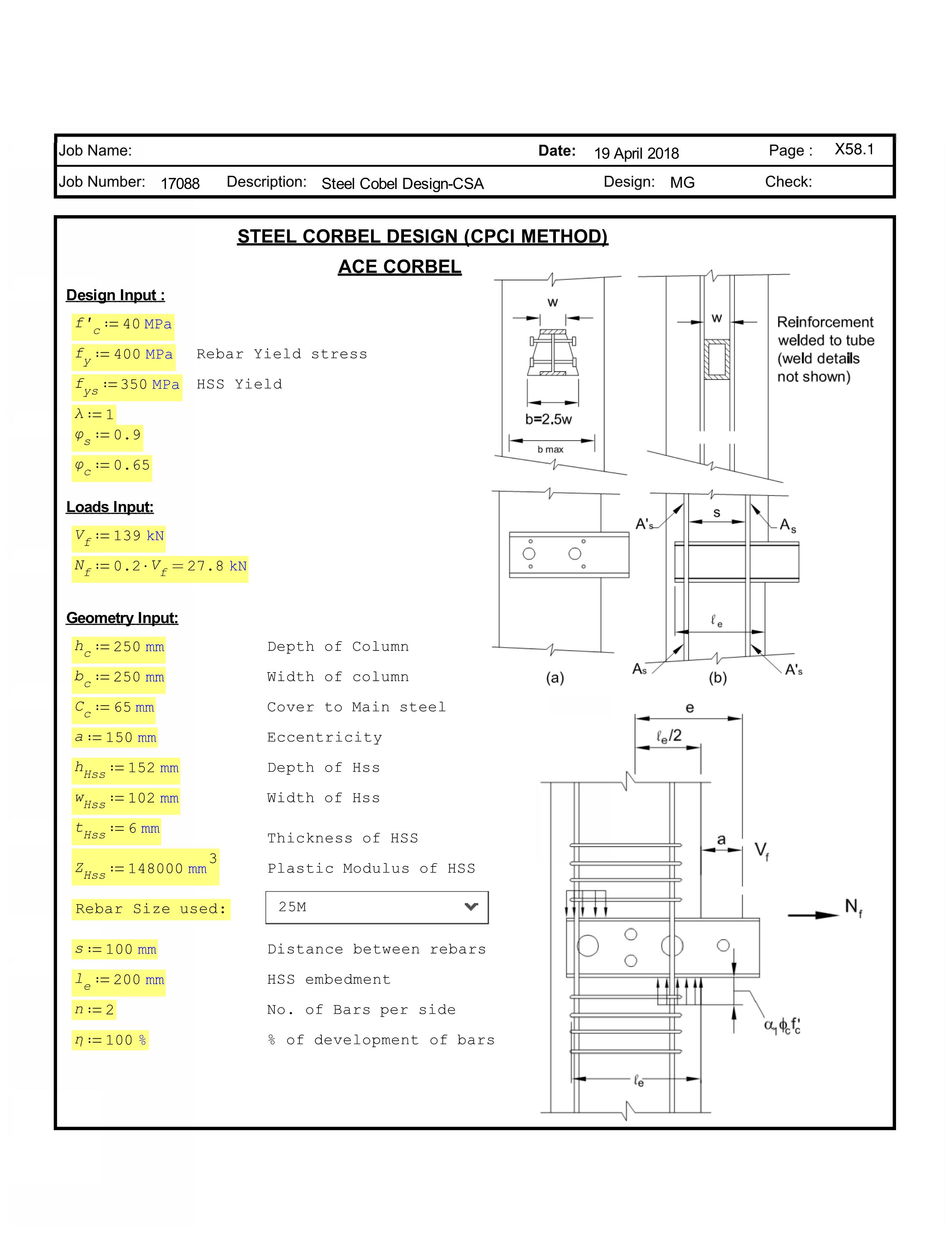

I am also attaching a snap shot of the sheet that I had it printed before for reference.

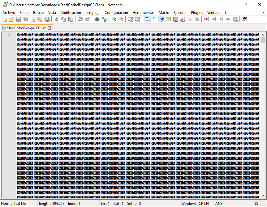

I opened your file on Notepad++ and I found that is full of NULL characters. Same you can see in any other text editos (atom, and so on)...
Sorry...
