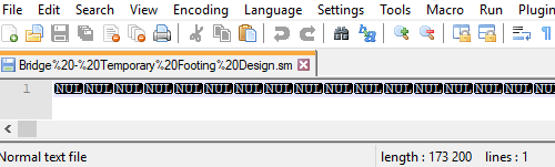

My notepad++ shows a long sequence of null control characters (unicode \u0000)... at least we have a date, this is an important clue... me too I remember at least another file like this (linked below)... keep reporting if it happens saving with most recent 0.98 versions...

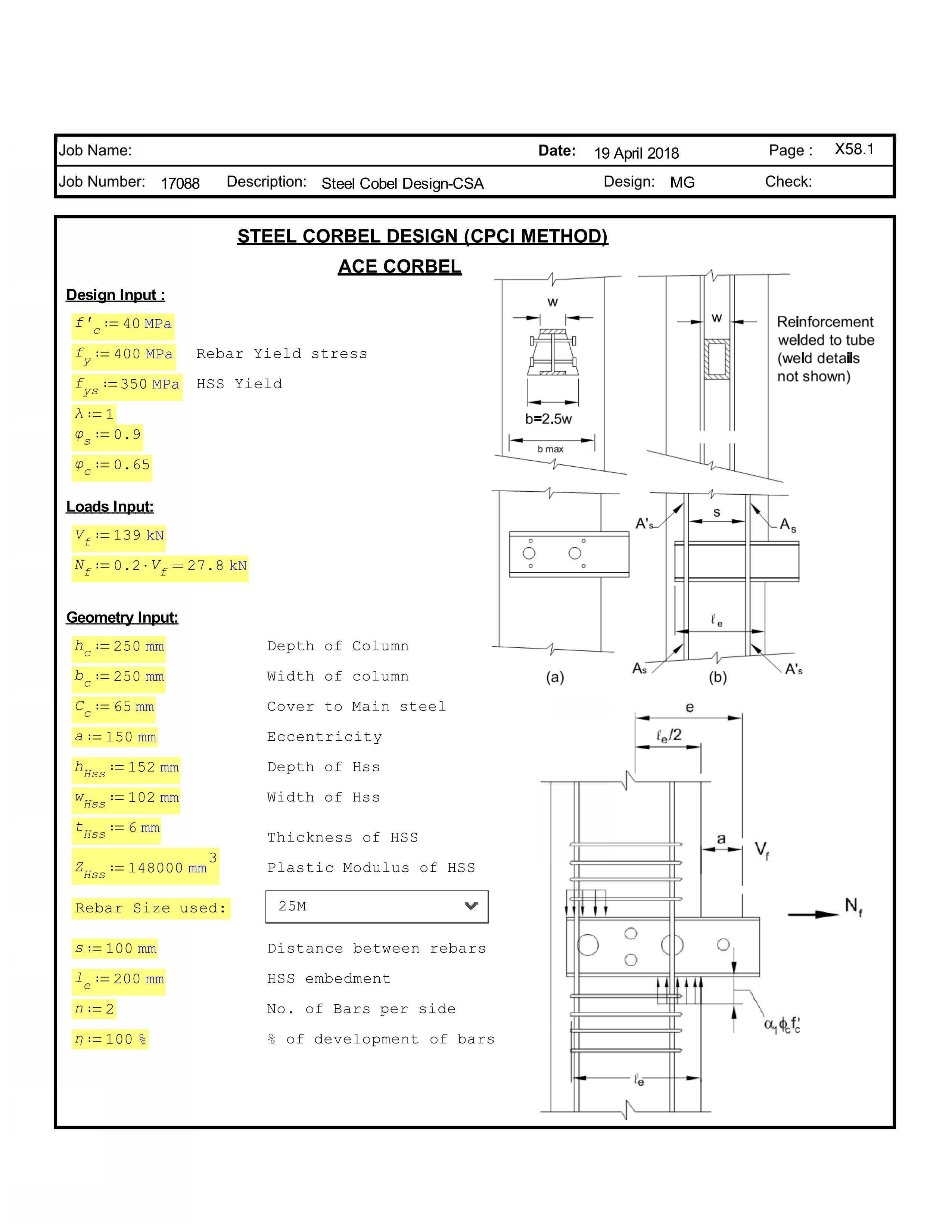

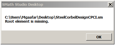

Hi, I was trying to open an Smath sheet but I always get this error message:
"Root element is missing"
the problem is all the copies that I have don't open and give me the same error.
Does anyone know how to fix this error?
I am also attaching a snap shot of the sheet that I had it printed before for reference.
Thanks

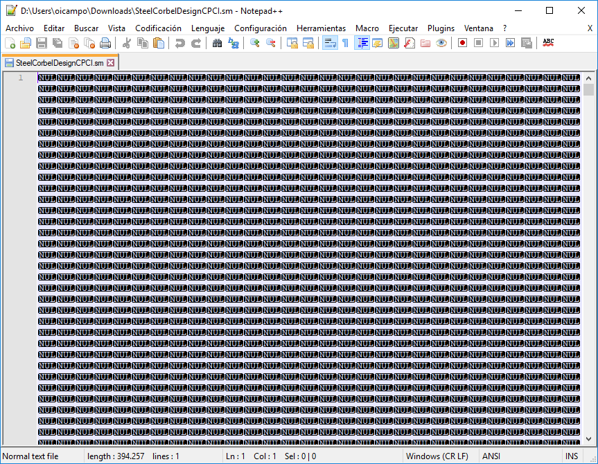

I also checked the size of file and it is 384 kb and not 0
attached file for reference.
SteelCorbelDesignCPCI.sm (385.01 KiB) downloaded 1425 time(s).

I opened your file on Notepad++ and I found that is full of NULL characters. Same you can see in any other text editos (atom, and so on)...
Sorry...
