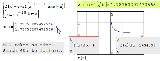

For short calculations it's a good alternative, but it seems very-very slow when long iterations are needed.
In some instances, Smath is slightly faster than Mathcad 11.
However, almost not observable.
In other instances, Smath is horribly slow.
1 min Julia in Mathcad takes over 2 hrs in Smath
Same observation Fourier CoC ... and more.
Please, attach your document for Smath Community to doctor.
